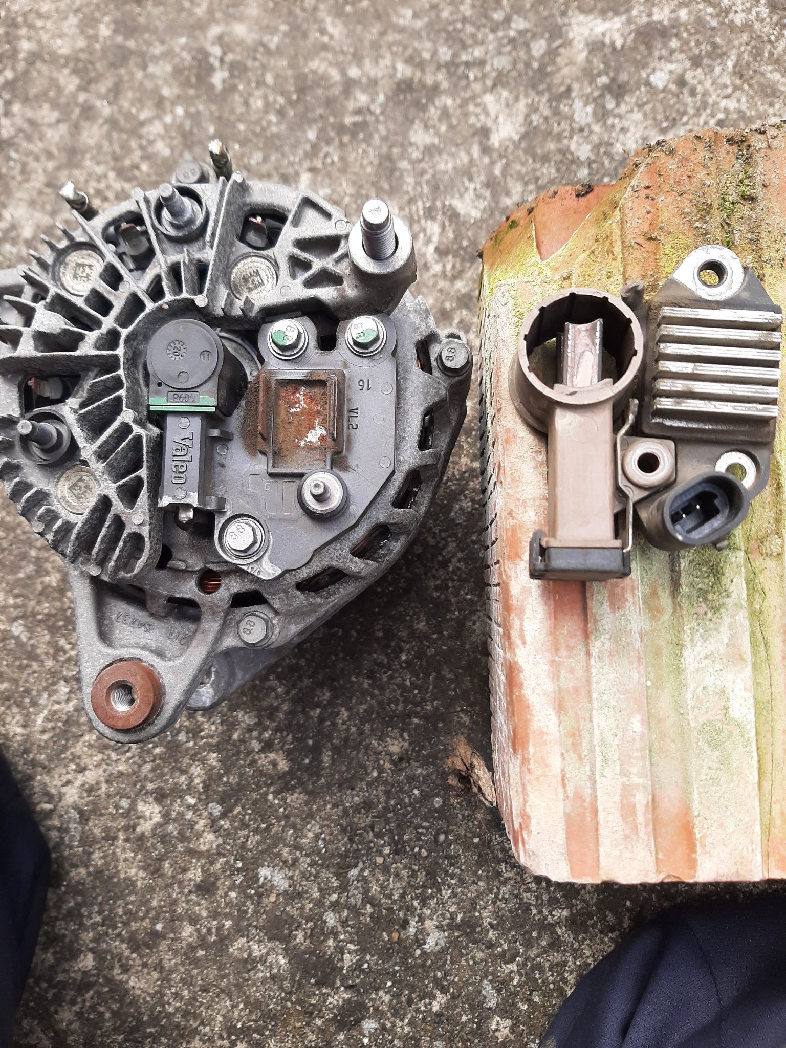

I now have the alternator off and I'm completely confused! There is the usual thick, bolted wire and thin wire with a plug that plugs into the plastic outer alternator casing. I was expecting to see a male spade or something in the socket for that plug but could not see anything. I wondered if that had broken off and was thinking in terms of soldering a new wire inside. I took the cover off but that socket does not have any wiring, it just seems like a dummy socket. I watched a YouTube video about changing brushes on a BMW alternator. It had a similar looking brush holder / regulator but theirs had the socket for the thin wire on the regulator. I dug out my old scrap Daewoo alternator and that also has the socket on the regulator.

So am I. In the photo is the bit on the right rotated relative to the other bit? And the brush holder turned over? If the rectifier goes where it seems to, have bolts been put back in?
The part with fins looks like a rectifier. The Valeo website refers to a regulator, but if it has one maybe it's built in to the rectifier or brush holder. Have you contacted parts suppliers? Can you buy a regulator (or rectifier/regulator)? Overcharging strongly suggests a faulty regulator.
And to go back to your question about silver solder, I can't see any soldered connections.
To my eye, it looks as if the pins have broken off, on the alternator, leaving just a rusty mark, where they were. That itself seems odd, usually the pins would be brass, rather than steel.
It suggests to me, that the regulator has been replaced in the past, and whoever fitted it, didn't manage to fit it fully, and water has got in.
