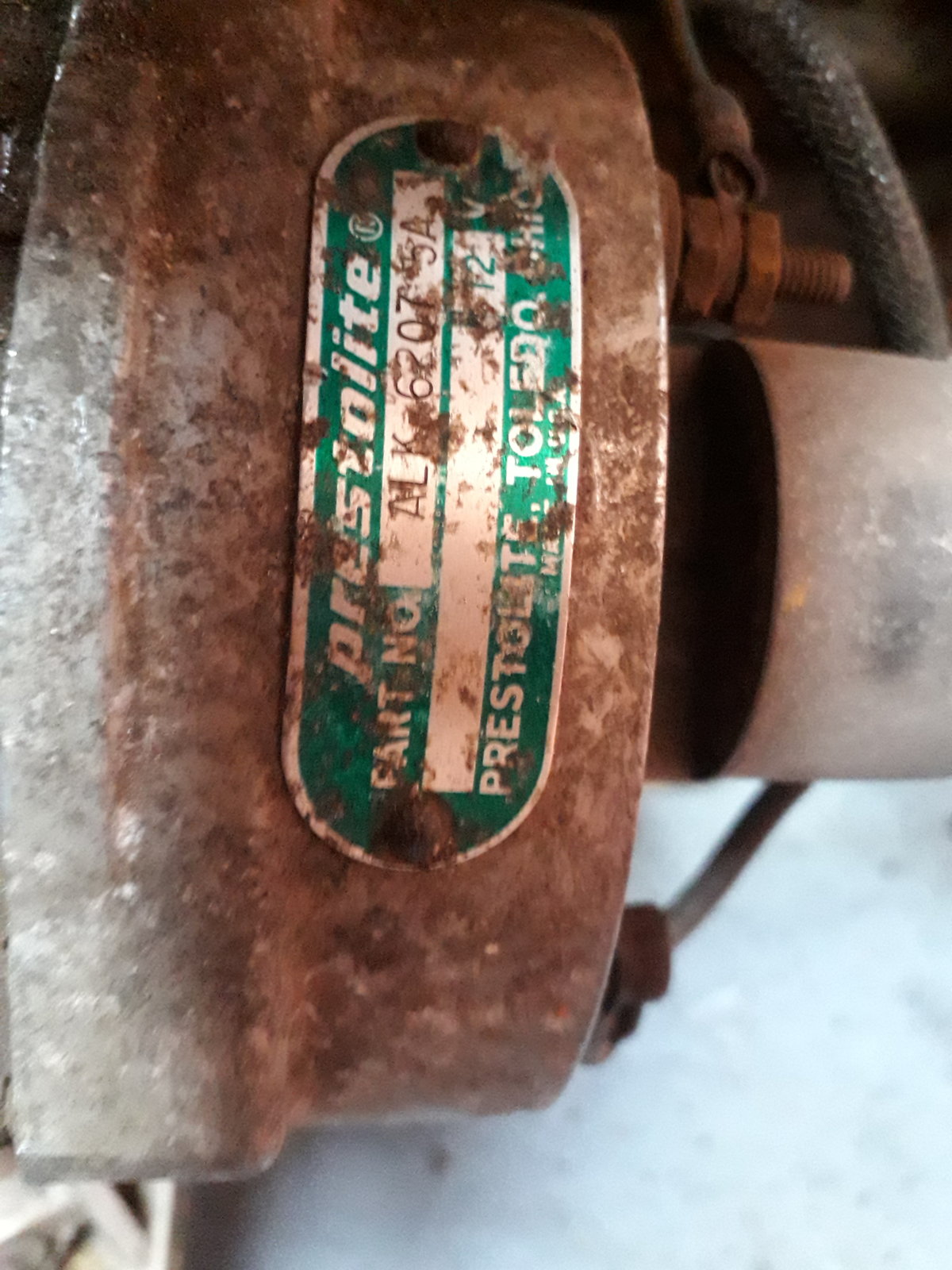

I'm looking for a replacement alternator for my boat that has a ford anglia engine in
The current alternator is a prestolite ALK 6207 5A

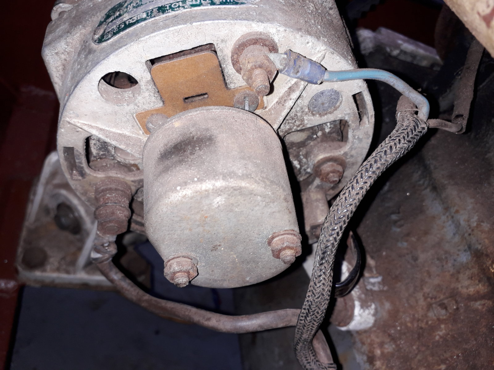

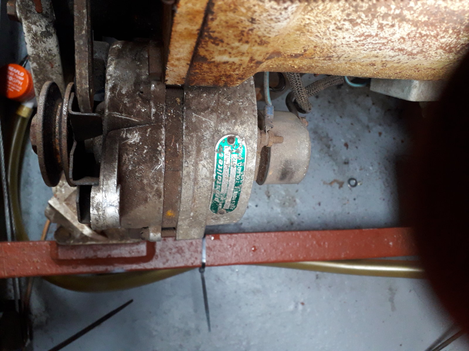

Probably started off with a dynamo! Has the Prestolite got an external regulator? Photos might help

It's from the USA! Wonder how it came to be fitted to a 105E engine? I'd have thought you could fit a Lucas one , there's normally some adjustment available or you could use some washers as packing. Make sure the pulleys line up and get the connecting plug .
Yes some of the conversions was done using a Ford Fiesta alternator
I'm not sure if the one that's currently on there has a built in regulator ?
The wiring on the boat is very basic (and messy)
I'm assuming the external regulator was removed as I can't see anything connected anywhere
The current one only has two wires I'm assuming positive and earth ?
No. All it will need if you fit a 3 pin Lucas alternator is the big wire connecting to the battery positive (or starter motor solenoid main feed - same thing) and a switched 12v ignition feed to the thin wire. Feed this through a bulb and that will be your ignition/charging light. The earth will be through the alternator body.
Usually the two wire system has one charging output wire (the thicker one)and one that goes to the charging light on the dash board.....the earth being taken care of by the alternator casing and car engine block. Id guess this alternator has its own regulator.

I found an exploded view of that alternator on the web, and fairly sure it doesn't have a built-in regulator. On your 3rd photo, the aluminium box on the right could be an external one. Most likely faults are brushes and regulator. If your brushes look worn and you can get hold of replacements, worth trying that. The external regulator is probably a vibrating-contact type, and cleaning the contacts and adjusting it might cure the problem.

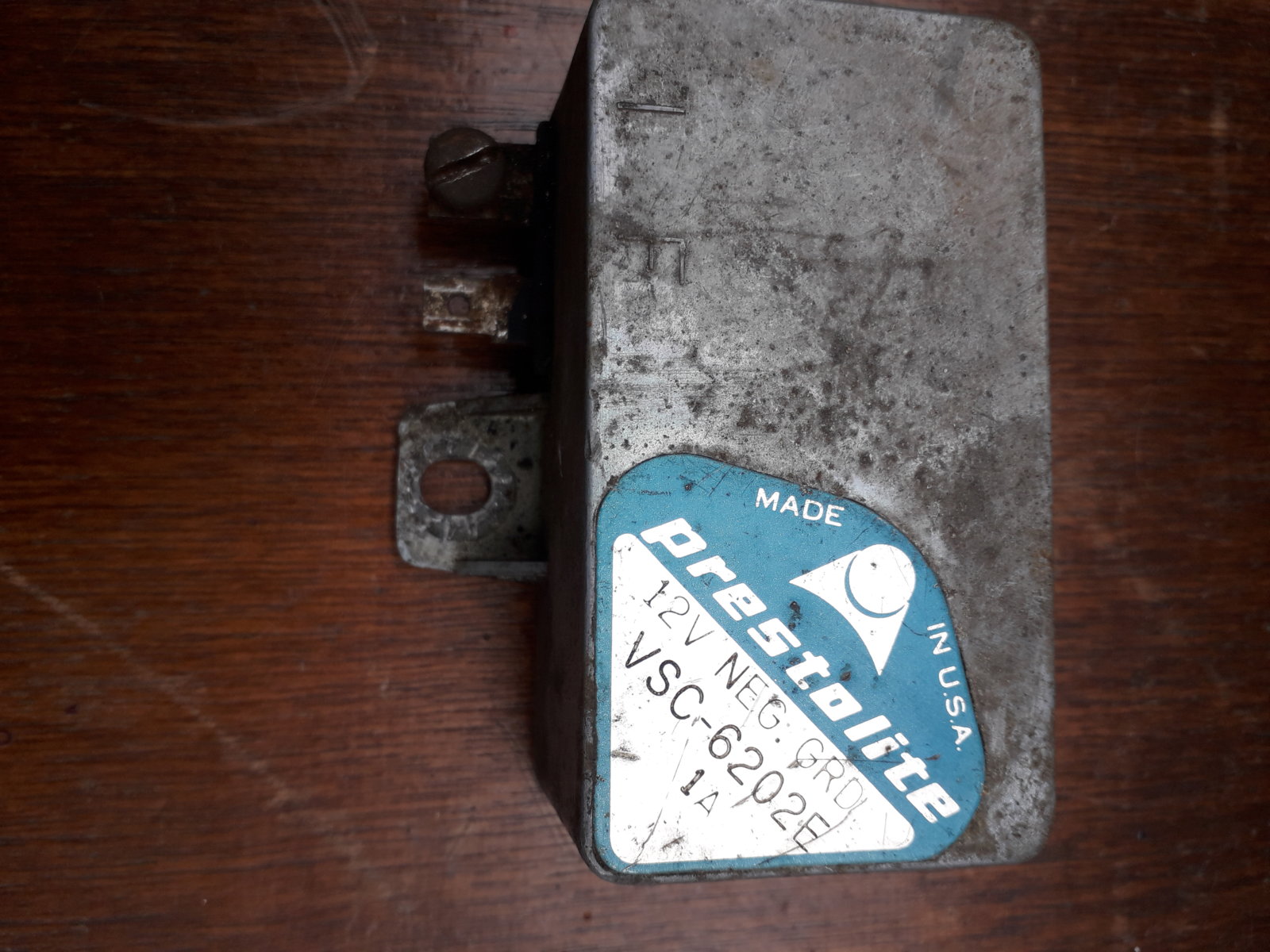

I'm assuming the box in the picture was the regulator from the old system I have removed it but do I need to do anything with the wires
One red and one blue I can't find where these go as the wiring is a bit of a lash up

The box is the regulator (quick google). Both wires will have been between the alternator and regulator. Now it's all internal to the alternator so the wires are redundant. You could remove them or just tie them up somewhere neat.
That's great I will just tape them up them

The regulator also had two one blue and one red on terminals marked I & F
