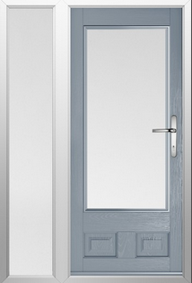

Not really a DIY question but we're looking at getting a new front door. Swmbo doesn't like the design of the current timber one. Composite offerings from local firms are too tall and apparently can't be made to smaller dimensions. Two companies have offered UPVC front door that can be clad in wood, and one has offered aluminium front doors as an alternative.
Any reason why we shouldn't go for aluminium?
Any pitfalls?
The door will be enclosed by a UPVC porch.

1910mm. It was discussed here: https://www.diynot.com/diy/threads/new-front-door.503230/
The problem is that SWMBO wants something like this:
Ah got you, At that height they would probably have to cut through the rectangles at the bottom so it wouldn't look very good lol
