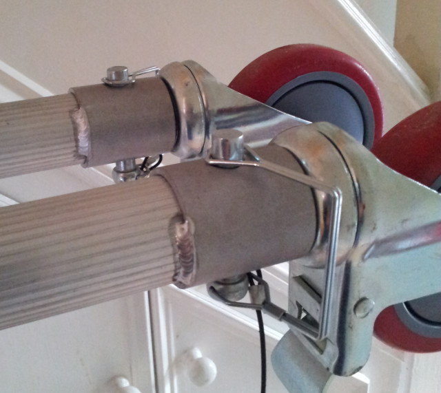

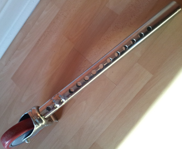

I wasn't too careful and ended up with a scaffold tower with castor legs that are not finely adjustable. They are adjusted by sticking pins into holes. The distance between the different level holes could be a little too wide. So, what is the best way to add shims to go below the castors, and what can I use for shims? I saw a scaffold video that said using planks was a bad idea because it could shift. I was thinking maybe using stacks of old news paper, or stacks of plastic wraps. Potentially I need to shim 3 of the 4 legs because the ground is so uneven. The tower does come with outriggers.

Sole plates would be good for soft ground. But for fine levelling of the legs, thinner material would be needed. The legs are adjustable in 10-15mm steps. Perhaps I need stacks of thin steel plates?

That's a poxy tower if it can't be finely adjusted. The instructions mention levelling, but don't state how this is done, says it has "adjustable" legs but does not mention how adjustable.
If you can't fine tune the levels, not only does a small discrepancy in level mean a much bigger one in plumb at the top, but it throws the four corners out and the whole tower will be twisted!
I can't believe they expect the user to have a collection of various sized packers.
Get in touch with the suppliers, as the regulations for towers state that they should be assembled in accordance with the manufacturer's instructions, and yet the instructions are as crap as the legs!

OK, I have measured it. The tubular part of the steel leg is 440mm length x 36.2mm diameter. The hole closest to the castor is solid metal inside. The other holes are in a tube. The diameter feels a bit non-standard. The ribbed aluminium frame is 40mm outside diameter. Any ideas on a compatible replacement? I only need 3 replacement legs while using 1 original.
