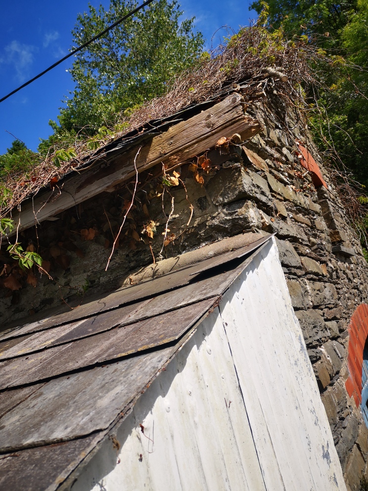

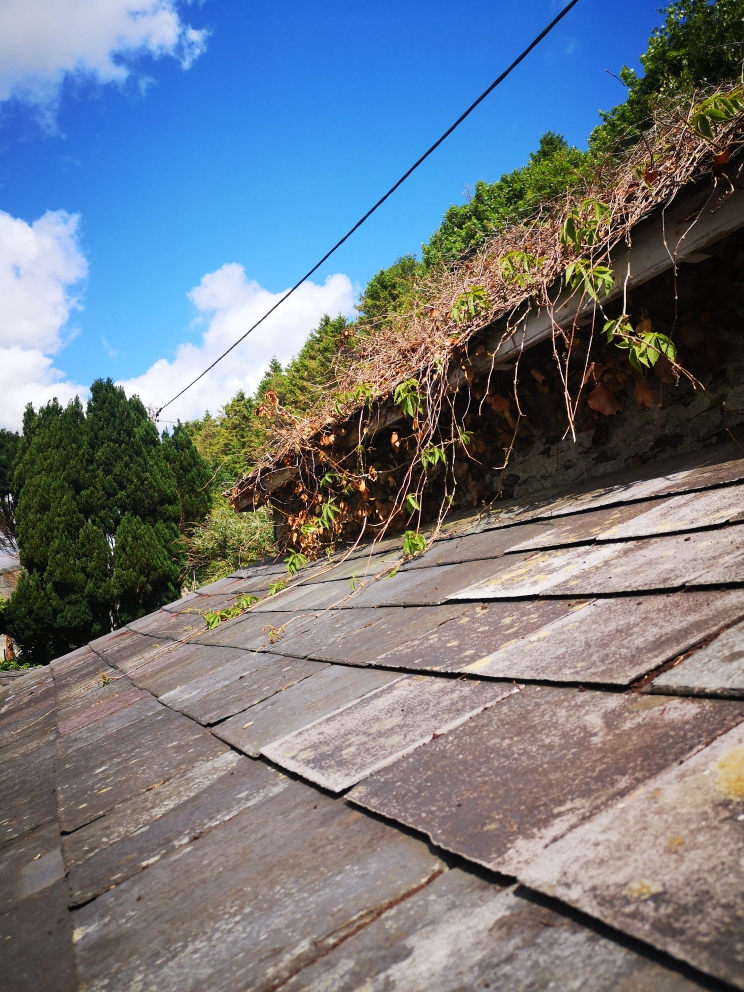

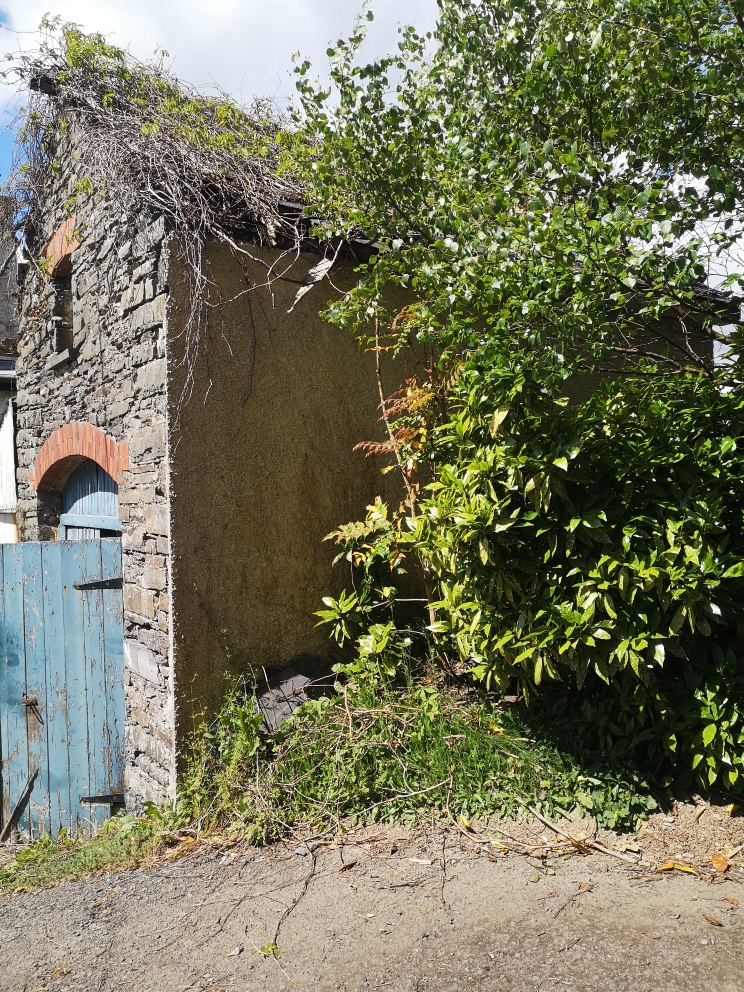

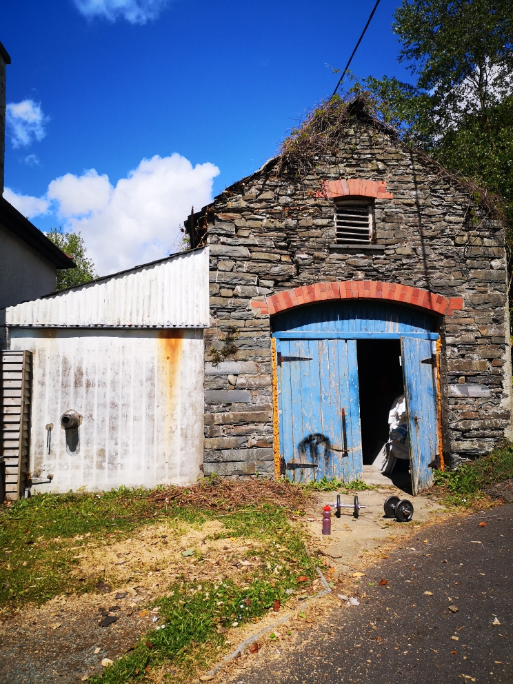

Hi
I am looking to work on the roof of a coach house which ivy has run riot on an the roof is in a poor state. There is a sloping extension running from the house up to the coach house and this roof also needs attention. I am debating if the purchase of a 5 Meter high mini scaffold could be used with scaffold planks to access the roof areas. Or I would need to get a scaffold company in. I have no idea how long I would need to repair the roofs and no idea if scaffold is charged by the week etc. The one side of the coach house is on a slope so not sure how a mini tower would cope with this?
Cheers
Dave

You are supposed to use portable scaffolding towers only to work from, not as a means of access to a part of a building such as a roof. This is because they are not designed to withstand a great deal of lateral loading, such as that which exiting onto a roof ladder (or climbing back down off one) might cause. In other words it ain't a safe way to use them.

No not listed as far as I know only moved in a month ago. There are problems with cracks running up from the arch and a wooden prop has been stuck in the doorway by the previous owner so considering blocking it up and making a new door way through the lower section. Thanks for the info re the scaffolding
