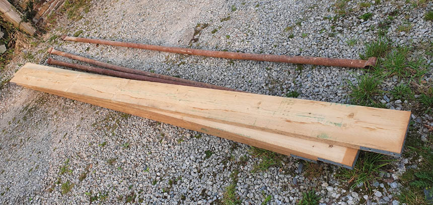

A couple of years ago I brought a hefty scaffold tower locally that was in good nick, that I painted and used once. Being that each section is 3 metres long, the tower footprint was a hefty 3 metres square. It came with no middle braces (or whatever the terminology is) which meant that I used 3.9 metre planks to span the tower, doubled up so as not to sag with my (thankfully) light weight on it. I'm looking to use it again but would rather use it properly this time, with a middle brace or two!
I *think* I am looking for a 3m meter length of scaffold tube and whatever connectors to attach it to opposing sections. From a very quick look round, the connectors seem to be slide on ones that can't work on my sections, I think I need some two part T connector that clamps the pipework. The tower is not branded so I can't ask the manufacturer. The outside diameter of the pipework using a micrometer is showing as 51.5 mm so I'm guessing it is actually 48.3mm or a standard size but with my paintwork adding extra!
Any ideas as to what I need to create a central support please?
Dan
I measured the sections I have and they are actually 2.8meters long. I can't find any horizontal brace that fits that size, they're all 2.7m which appears to be a standard size. My tower actually came with diagonal support braces but they don't solve the problem of supporting the planks at safe intervals. Is there a way of, say, getting scaffold tubing cut to length and then attaching those open/slit ends? Or are they only available as welded single piece items? Not sure what this tower would have used originally to support planks safely....

Plank back to front in the middle then the others left to right but shimmed up by one plank? Or screw some plywood strips to the bottom of the planks to reinforce them? Even something fixed between and a ratchet strap may work if its just a little more support required?
Thanks John, that kind of thing makes more sense!
The Boss thing is a brace, not a transom and it won't support anything much because it's aluminium, and designed to keep elements a certain distance apart rather than take any transverse weight. I'm sure you all knew that but I thought I should just point it out.
The key thing here, is that the OP has managed to survive spanning the full 3m with board (rather him than me). So even a single transom will significantly lower any risk. It's suggested transoms are at no more than 1.2 meter intervals for light use, closer if they're carrying any weight, which means to do things properly would require at least two. 3m is close to the limit for scaffold bays, so I'm wondering if you're supposed to use staging boards with this tower, they give a bit more rigidity than standard tubes would over 3m (although they will still bounce about some).

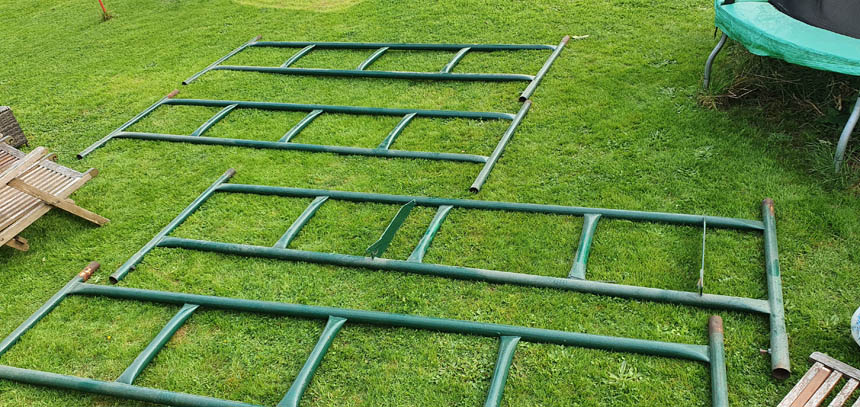

Thanks Shagster, that's more the clamp I was thinking of and thanks for giving me the correct 'transom' terminology. Anything is more stable than what I've got and would allow me to use the planks I've been doubling up with, so I'll see if I can pick up three tubes locally long with the clamps. These are the sections I'm dealing with:
and it came with what I believe are diagonal braces (but not used yet) with a bit of surface rust, as can be seen here behind the planks:

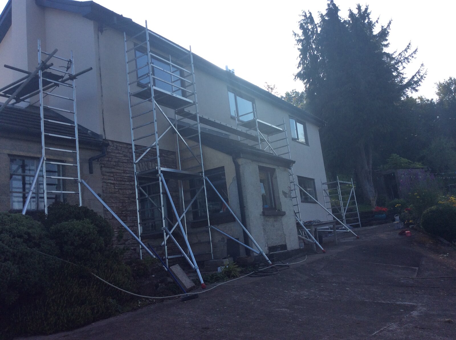

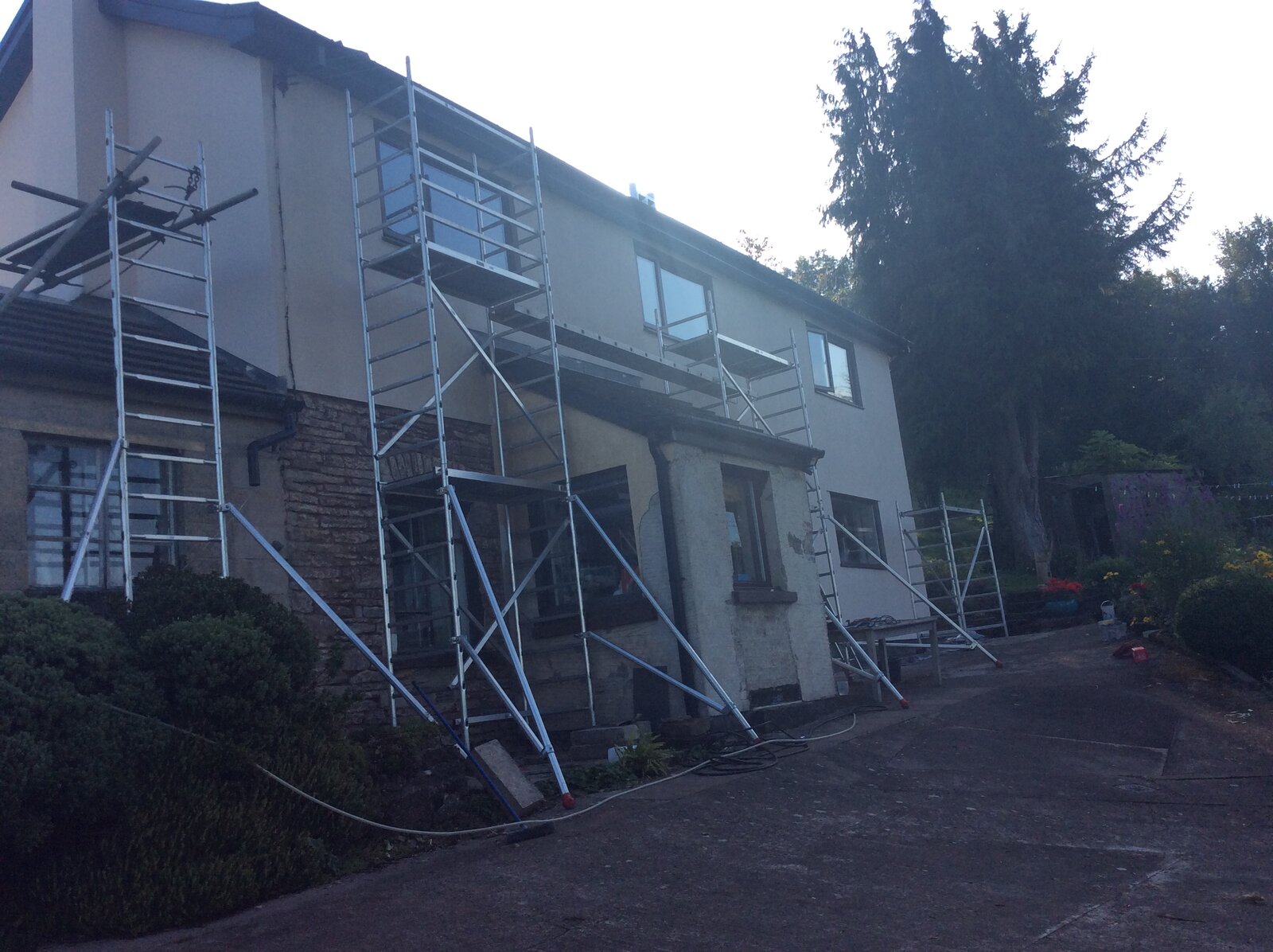

Someone mentioned it earlier but if I need to span between two frames I use a ladder with a scaffold board on top as seen over the porch
