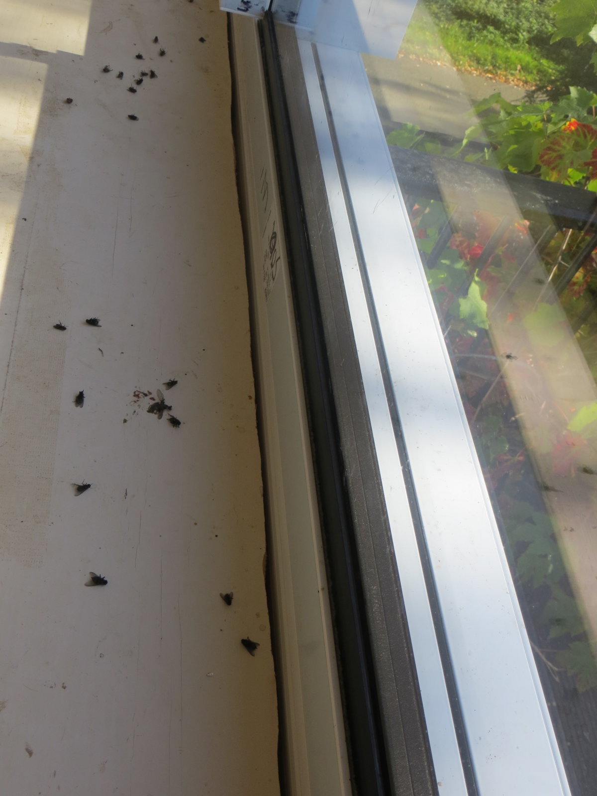

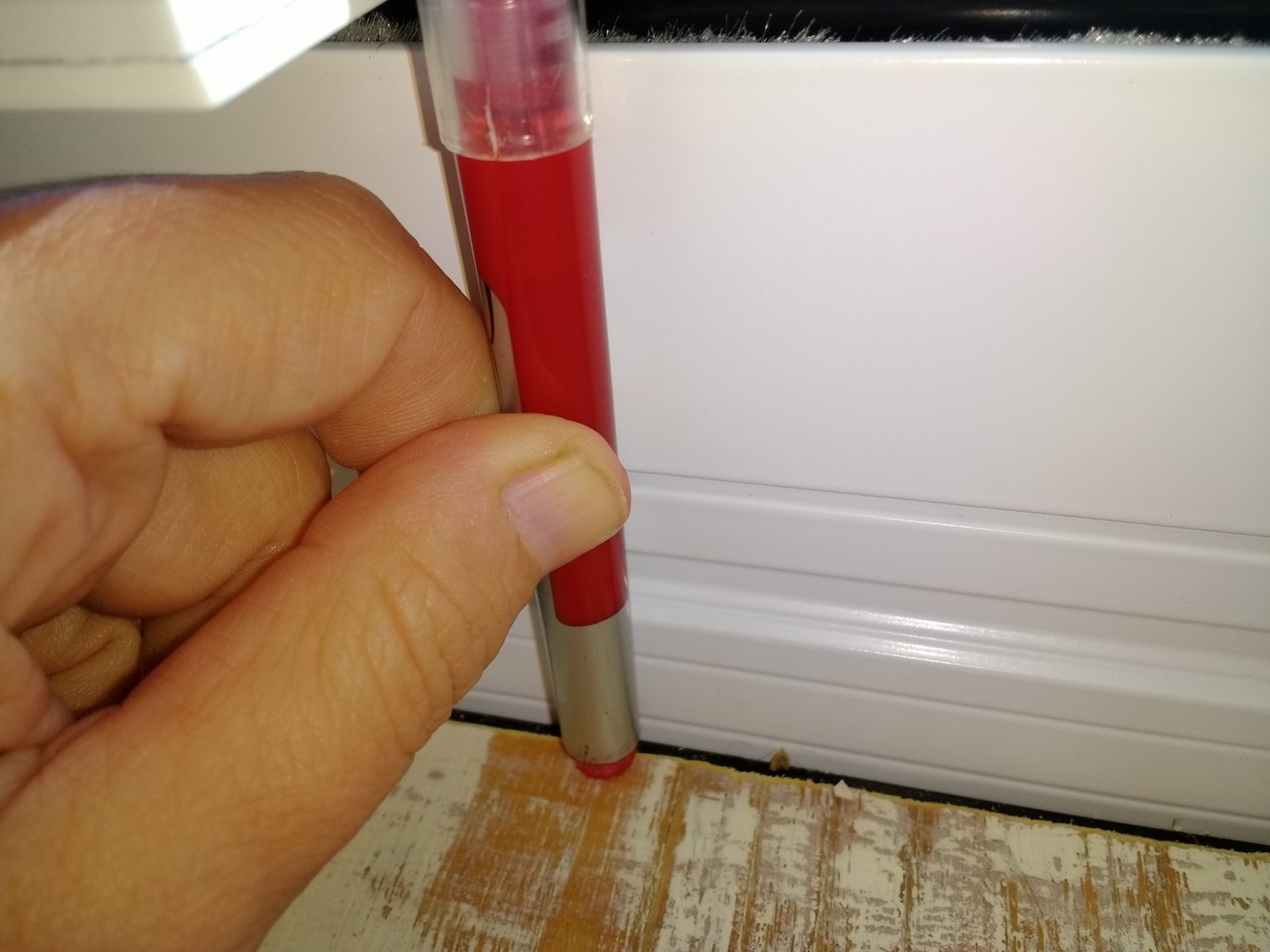

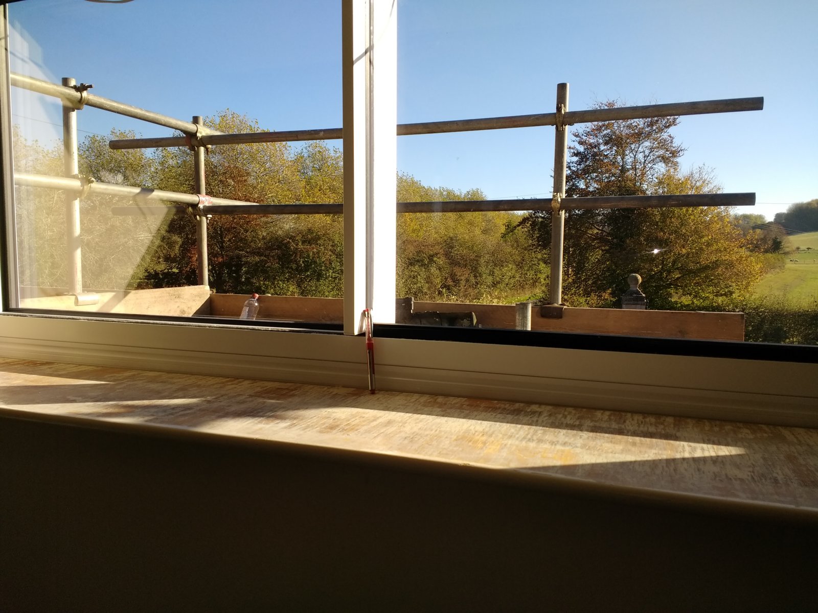

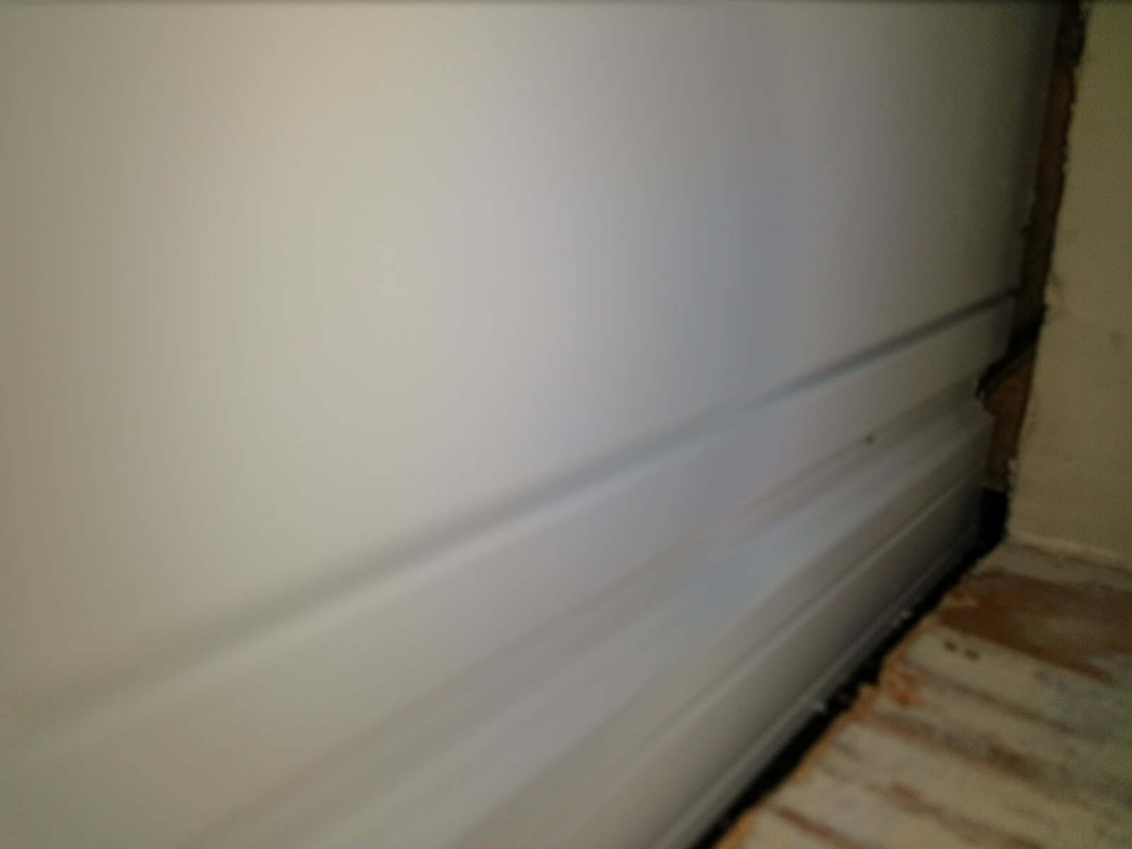

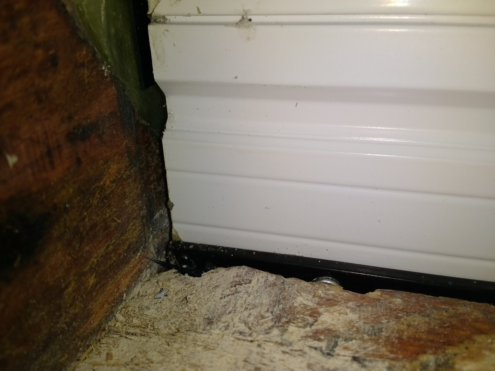

good point - these are pics from the only window where they didn't retrofit the cill. The screw visible in one picture is the cill screwed onto the existing wood.
(the fact the plaster and wooden cill need some work is ok, that we planned to do anyway - it's tidy because my husband cut it out, not the fitters!)
I hope this helps. It looks tidy enough but you can see the fact the whole frame is visible (pen for scale), there is a gap (which could be covered with wood and ? some expanding foam) and the window seems to sit directly on the cill which will soon have snow on it. The last picture is another window, the one where they were able to hammer in the cill (whole house is a wreck following flood in March, dead flies came through fallen ceiling, now hoovered up!)

I cannot see a massive issue. Looking at the picture the chill is sitting on the concrete/timber so surely it can only sit there and cannot go any lower. The outer frame looks chunky and I and add that to the cill it looks very chunky but surely you see the product before you bought it. You could of maybe gone for a low threshold option but doubt it would have had a weather rating.

Did you ask specifically for small meeting styles and leave the rest to them? Most of the makes with thin meeting styles actually have very large outer frames. Generally if it was a new build you would hide most of the frame with plaster internally.
Cant really comment too much on the make/fitting without some overall photos.
The cill/bottom frame details is ugly as hell.
The timber cill cut is poorly done but sometimes there are big nails that cause the saw to snag so it does happen sometimes and is not a big problem to sort out. Some foam and some filler which will also stop the draft that is likely coming in through the cavity wall (assuming you have this).
Ideally you would remove the window-board, Close off and insulate the cavity and maybe refit some nice new window-boards higher up to hide all that frame. That would be a bit of work and expense though.
I wouldn't be happy about the cill that was cut to get it in. Fitting the cill after is a very strange thing to do!
