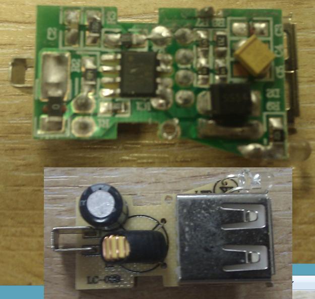

Not sure on the type of converter I have but there is no heatsink. It's a fairly simple circuit with an IC, cap, resistor & (possible) toroid.
Based on the information you guys have provided I think it would be advisable to go for the 12v/1.6a output.
"IC, cap, resistor & (possible) toroid"
If it has a toroid then it's almost certainly an inverter unit - but a photograph would confirm

I see a chip and a coil so could be switch mode or could be simple voltage regulator and smoothing. It would completely change what is required.
A switch mode unit may be able to accept a volt drop of 50% and still work giving a steady 5 volt output but a voltage regulator may only accept a volt drop of 20% and would also load the supply higher than the switch mode. Plus create more heat. So without knowing which type one must assume 2A at 5 volt requires 2A at 12 volt. Assume a simple LM7805 voltage regulator for current calculations.

I agree with Eric. that power supply is a switche mode device.
If you are running two or more switch mode power supplies from the same DC source you may find they interact with each other and stop operating properly. The cure is to fit an electrolytic capacitor to the input of each power supply. 100 uF 25 volt should be OK for a 2 amp output supply.
