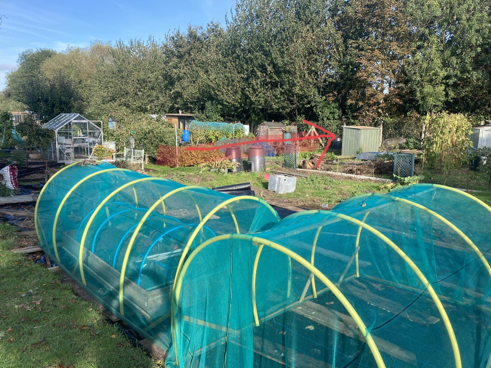

I am building a plastic shed on top of concrete council slabs and I need to anchor it to the ground. It has anchor points along the floor where you are supposed to drill.
I'm thinking of getting some shield anchors for this job, probably these: https://www.screwfix.com/p/easyfix-shield-anchors-m6-x-70mm-5-pack/4516g
Does that sound like a good idea to you guys?
Is there a risk that I'll split the slabs with these? I would need to drill quite close to the edge of the slabs (10-15cm).
Anything else I should consider? I heard of people just using a standard 7mm rawl plug with a smaller bolt but I figured I might as well invest the 3 quid to do it properly.
