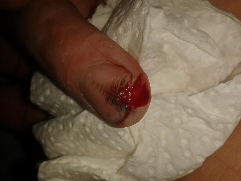

It's good to be reminded on occasion just how squishy the human body is. And how the loss of concentration for a fraction of a second can instantly change your life.
This one, thankfully, isn't bad. But after 3 hours of grinding a floor, I was tired and the goggles were getting a bit fogged, but I only had a little bit more to do, so I adjusted by grip with the grinder running and grabbed around the finger guard... ouch.
Lesson of the story. If you feel tired, just stop and take a break. If you can't see, clear you goggles. And never forget that every single tool has the ability to chew you up if you slip.

I smelt my leather gloves burning and realised that was a subtle clue that my finger was too close to the grindy bit.
Angle grinders seem spectacularly badly designed with nothing to properly hold on to.
I'm not a big glove advocate. For one, my history with machine tools taught to never, ever, ever wear gloves as they can get caught. And I carry that through to anything spinny. My finger got a bit chewed up without gloves on. If I had gloves on, they could have got caught, pulled in and my finger twisted off.
Unfortunatly, due to their nature of being hand held, high powered large faced abrasive stock removers, there's little you can do to make them safer.

use welding gloves! there is NO way an angle grinder can entangle a welding glove!
im guessing that you dont have the guard fitted either? most people take them off-as do i because they get in the way-but they do go a long way towards keeping your fingers the correct length!

Welding gloves would be mostly impervious. But then you start to loose the feeling of the tool and the risk of it slipping / cutting the wrong place can increase.
I do keep the guards on (half guard for 4", full or half for 9") depending on the job. But yea, got my finger trapped in the guard. So ironically, would have probably been better without.
