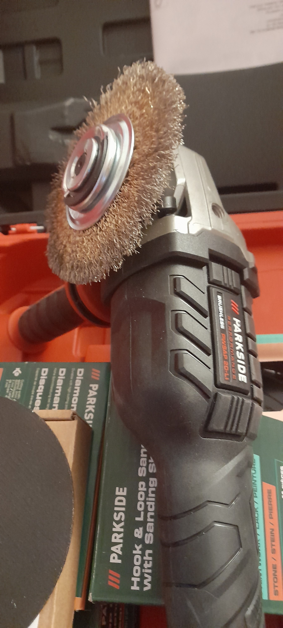

The discs advert says 10,000 RPM, but the disc says 4,500 RPM the max speed of grinder is 10,000 RPM, but it does have 6 speeds, but nothing in the paperwork says what speed it runs at when speed 1 is selected. So I am not sure about using the brushes, clearly using eye protection etc, but they do look as if designed to be used with a grinder, so has anyone had problems using these brushes with grinder speed set to lowest?
The hole in the one illustrated does not look big enough to fit an angle grinder so I would suspect you would need an arbour and use with a drill.

View attachment 410328The discs advert says 10,000 RPM, but the disc says 4,500 RPM the max speed of grinder is 10,000 RPM, but it does have 6 speeds, but nothing in the paperwork says what speed it runs at when speed 1 is selected. So I am not sure about using the brushes, clearly using eye protection etc, but they do look as if designed to be used with a grinder, so has anyone had problems using these brushes with grinder speed set to lowest?

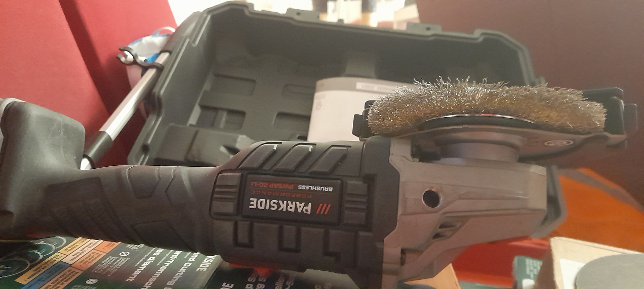

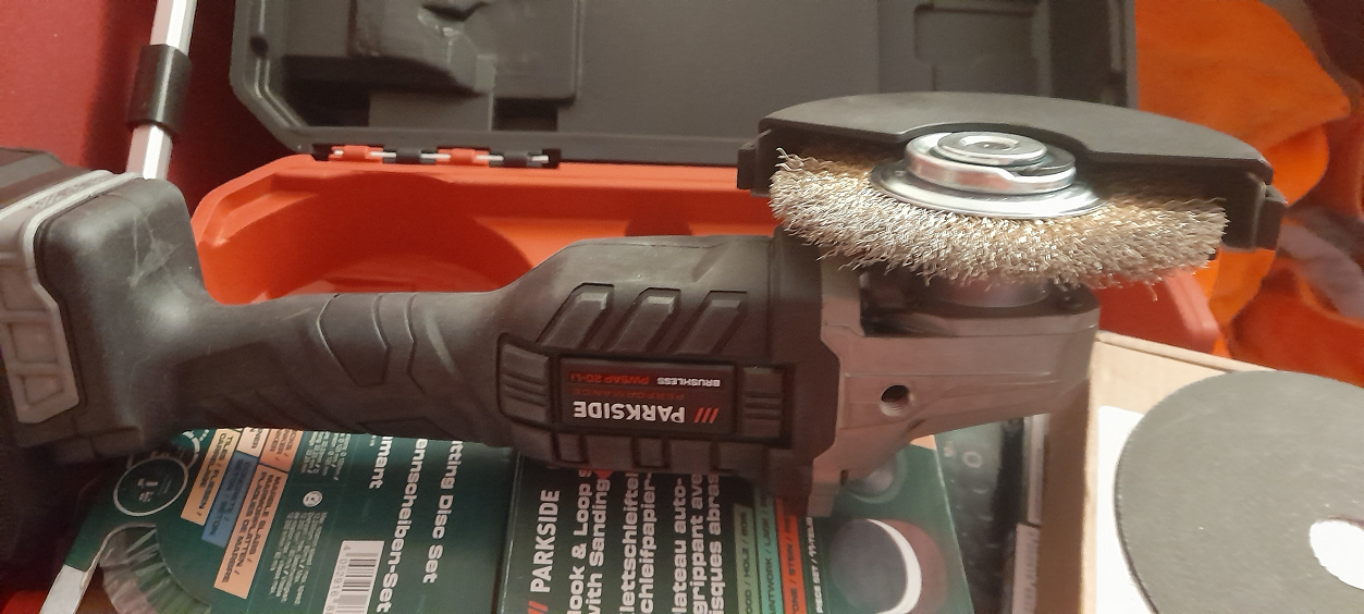

1773600883023.png1773600955963.png1773601045269.png You got me wondering, the mounting flange 23
will not fit in centre of brush. But with that left off, seems a good fit. Tried first without guard, but the clip which holds the guard from rotating, did not catch but very close, so tried it with guard, and it does seem to fit OK. Both cases nothing catches, but not much clearance.
Reasonable sure at speed 1,
it is below 7500 RPM, but I have with the sanding disc a boss came with it,
to allow it to be used with a drill, it does not seem to fit very well in the wire brush hole rather loose, and I found the same with garden tool 1773603042344.png the brushes don't seem to fit snug, so I think maybe best playing safe, and put them in the bin?

For wire cups and wheels the number that matters is the accessory's maximum RPM. It needs to be at least the grinder's no-load speed at the setting you intend to use. The dial on a variable-speed grinder is not necessarily a calibrated RPM limiter, so I wouldn't use it to make an under-rated brush “safe”. Also check spindle thread, guard clearance and maximum diameter.
I put together a quick check for the mechanical compatibility and RPM margin here: https://powertoolspros.net/tools/angle-grinder-disc-check/
If the brush isn't marked with a max RPM, or its rating is lower than the grinder can deliver, I'd bin it rather than rely on the speed dial. With a suitable cup brush, start low, keep the guard on, and stand out of the plane on the first run.
