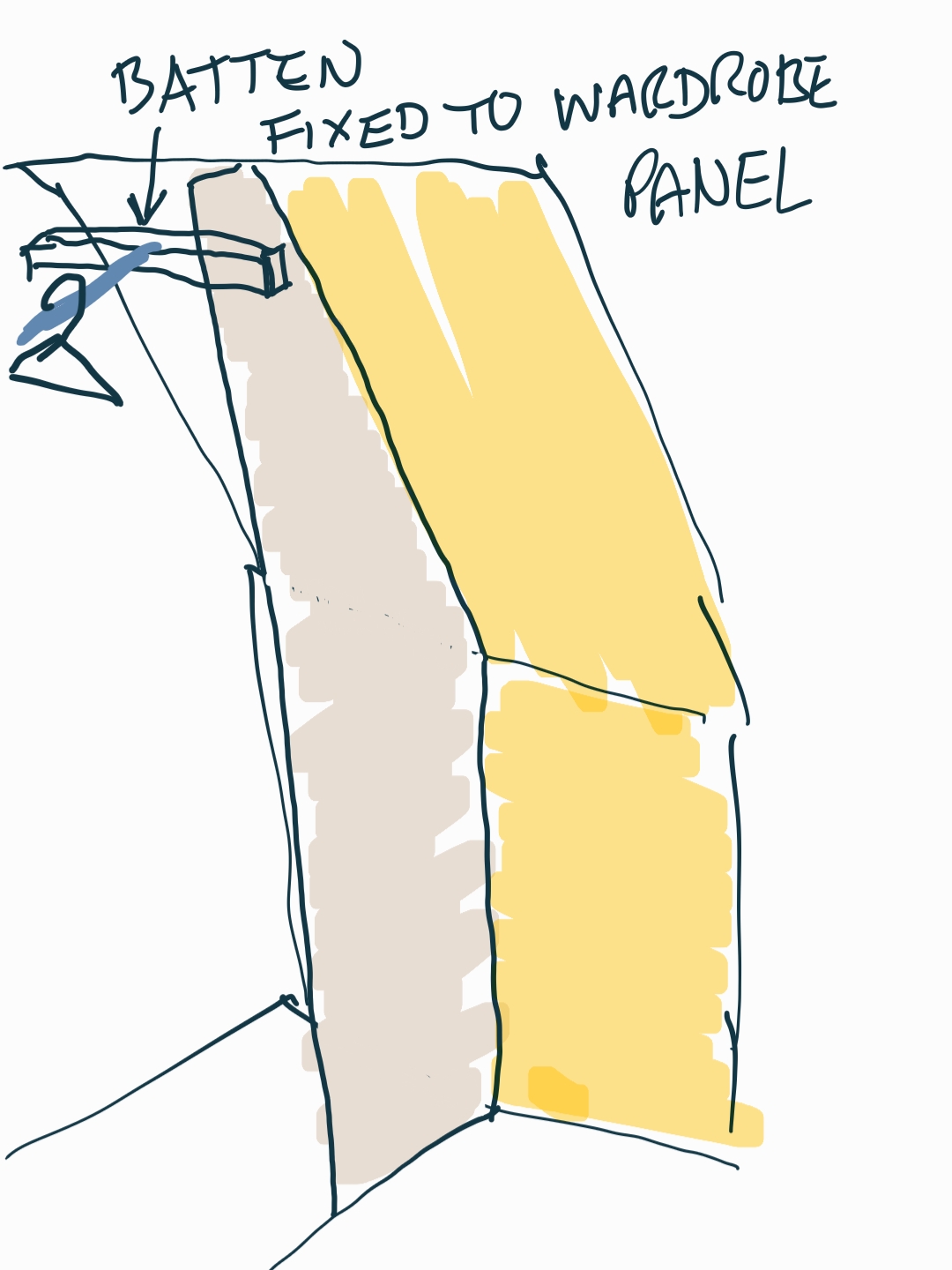

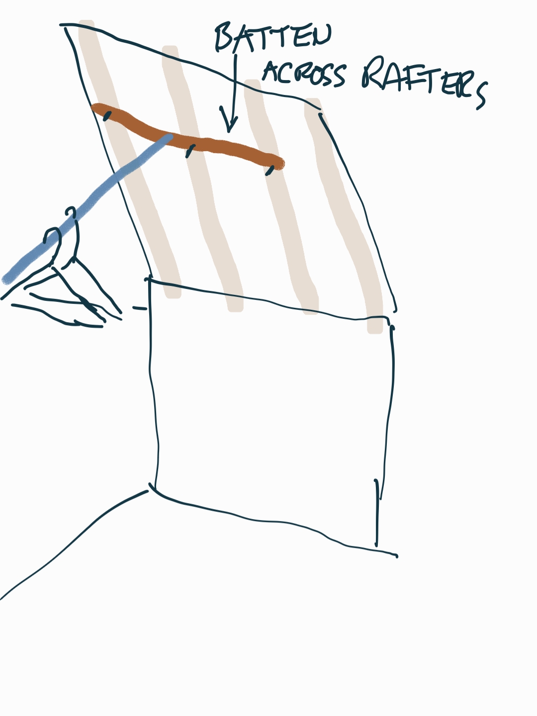

Hello,
I have a dorma in my house and I'd like to box off the underneath to make a wardrobe.
I don't know how I'd attach a wardrobe rail to the angled ceiling though. I'm thinking I would get a block/batten and cut it at an angle to match the slope of the ceiling to make a straight edge for my wardrobe fitting.
Anyone have any advice on how to do this please?
Two principles
To get the angle right for the rail, hold a spirit level on the wall horizontal then use a sliding bevel on top of it - then tighten it up once its the correct angle :)
