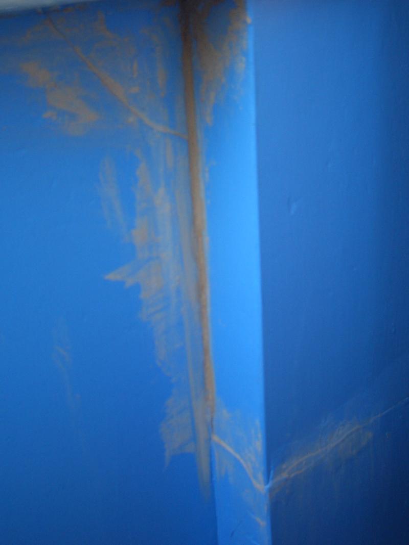

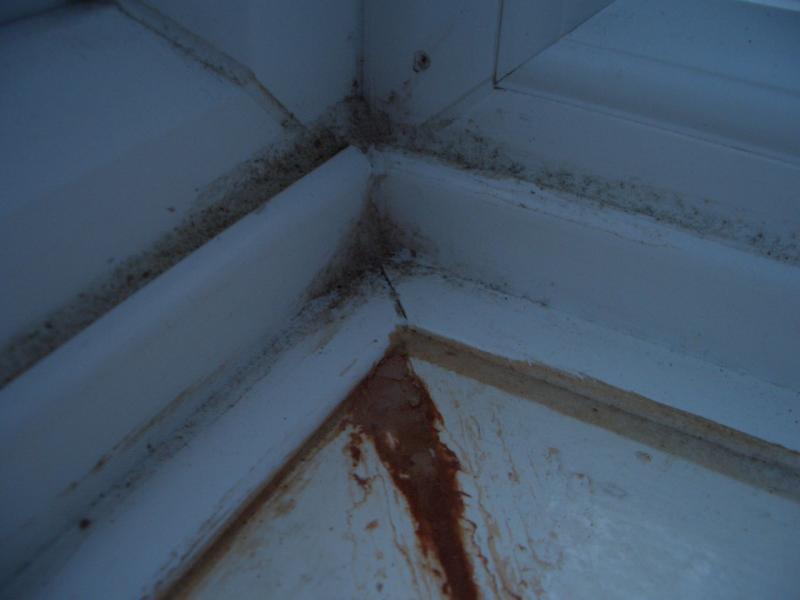

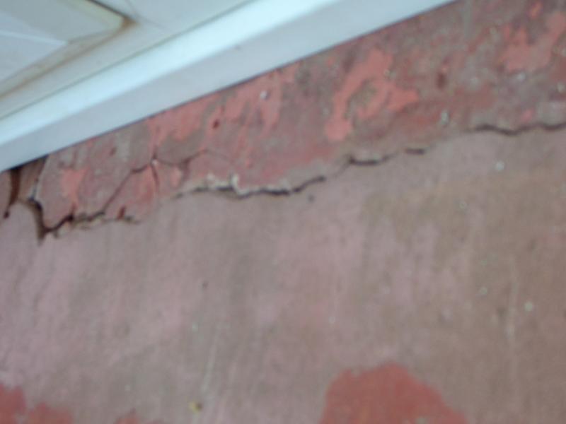

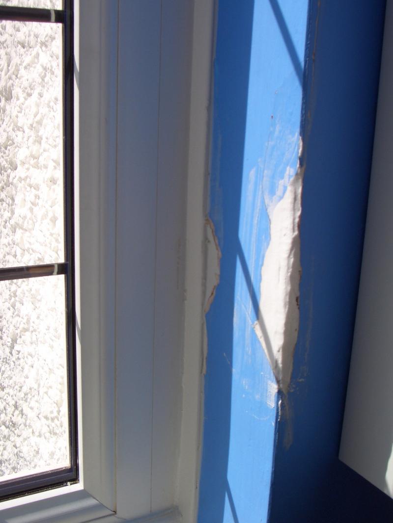

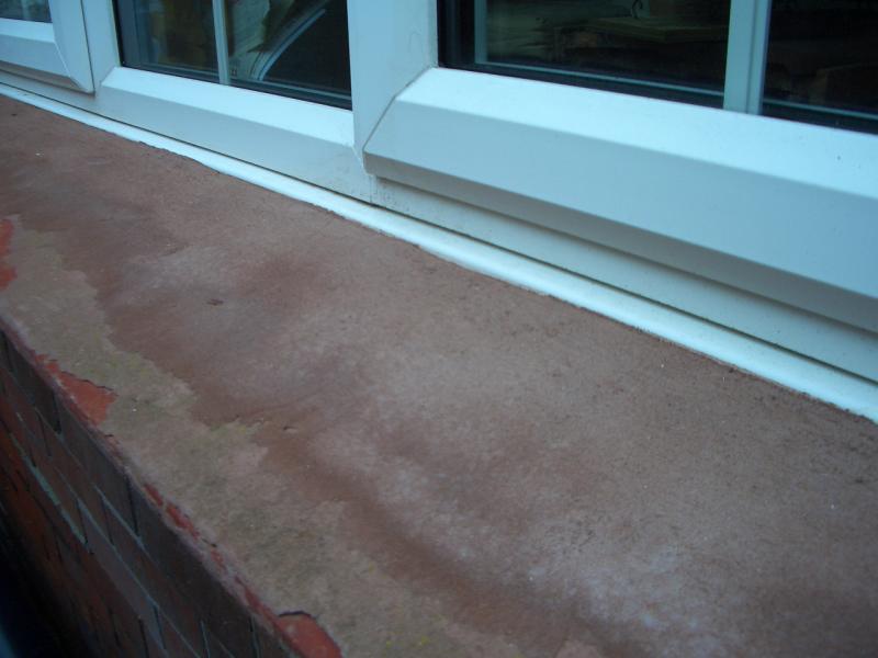

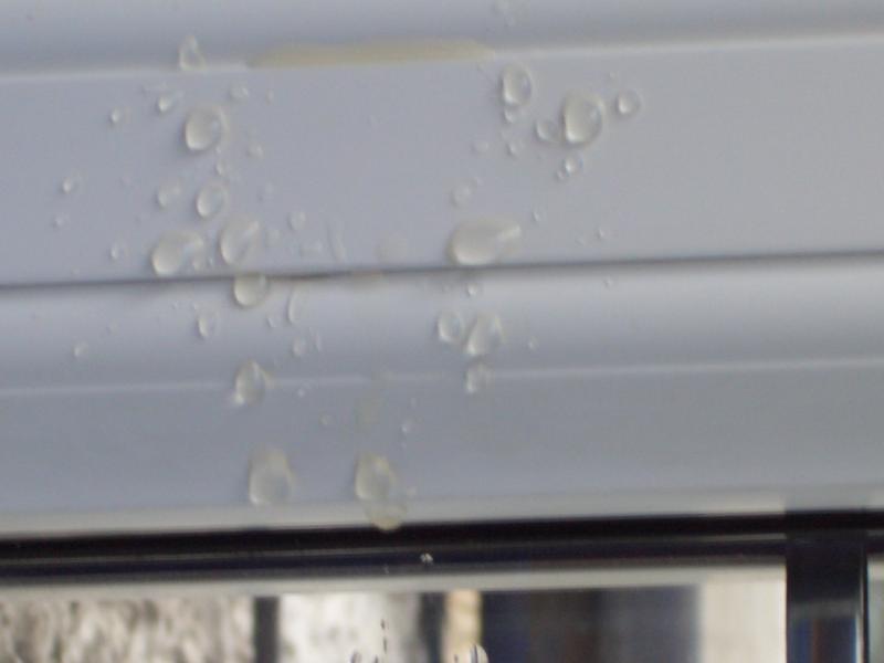

Anglian fitted houseful of windows - rain poured through when first rained. Still leaking water and air everywhere = cold house max 20 degrees in winter with boiler on full.
Repair team did less than a third of items on small list, created more problems with cement too high on sills so water into cavity. More than 2 YEARS later... Anglian fobbing customer off... despite survey reports which also say windows have been made too small and filled with plastic extensions. Plastic trims not sealed so leaking air,

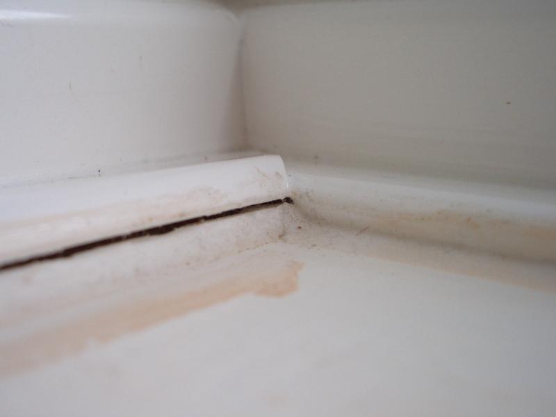

when lifted daylight can be seen from outside, sealant is wrong type so attracts dirt and can't be cleaned so looks like derelict building,

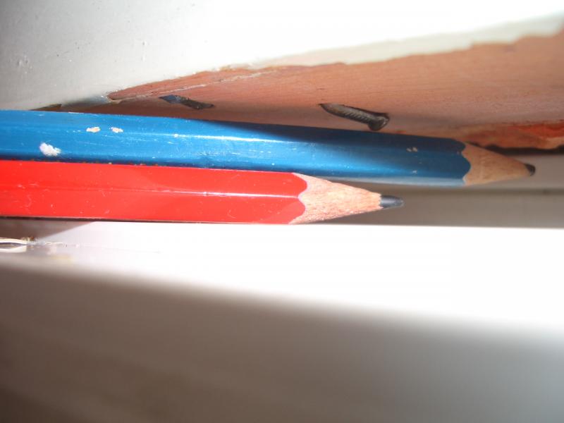

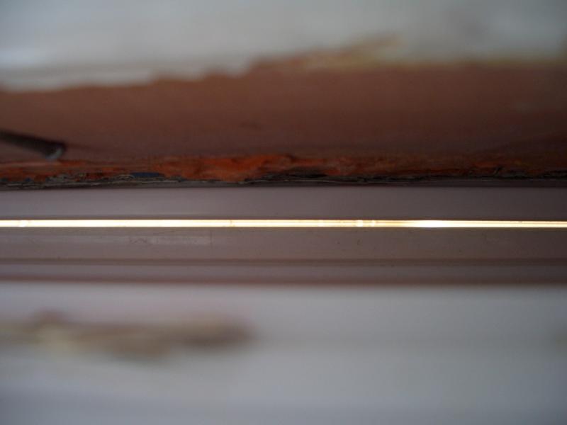

huge gaps now found around windows- you can put your hand through,
thin plastic covering 30mm cavity so NO insulation.
Defeats the purpose of double glazing and is worse than the old windows.
No privacy as Anglian have added so much extra plastic to cover the problems that blinds and nets can't be returned so main curtains have to be closed all day.

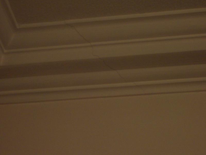

It feels like the house is destroyed, problems have gone on and on and on and on. If this were in their glossy brochures they would be out of business. 10 year guarantee is worth nothing as this is a rogue trader job by a certified national company. Bay has dropped - cracking walls of upstairs room and ceiling and walls of downstairs room.
and ROUND bay poles put on SQUARE bay - destroying symmetry with neighbouring houses.
