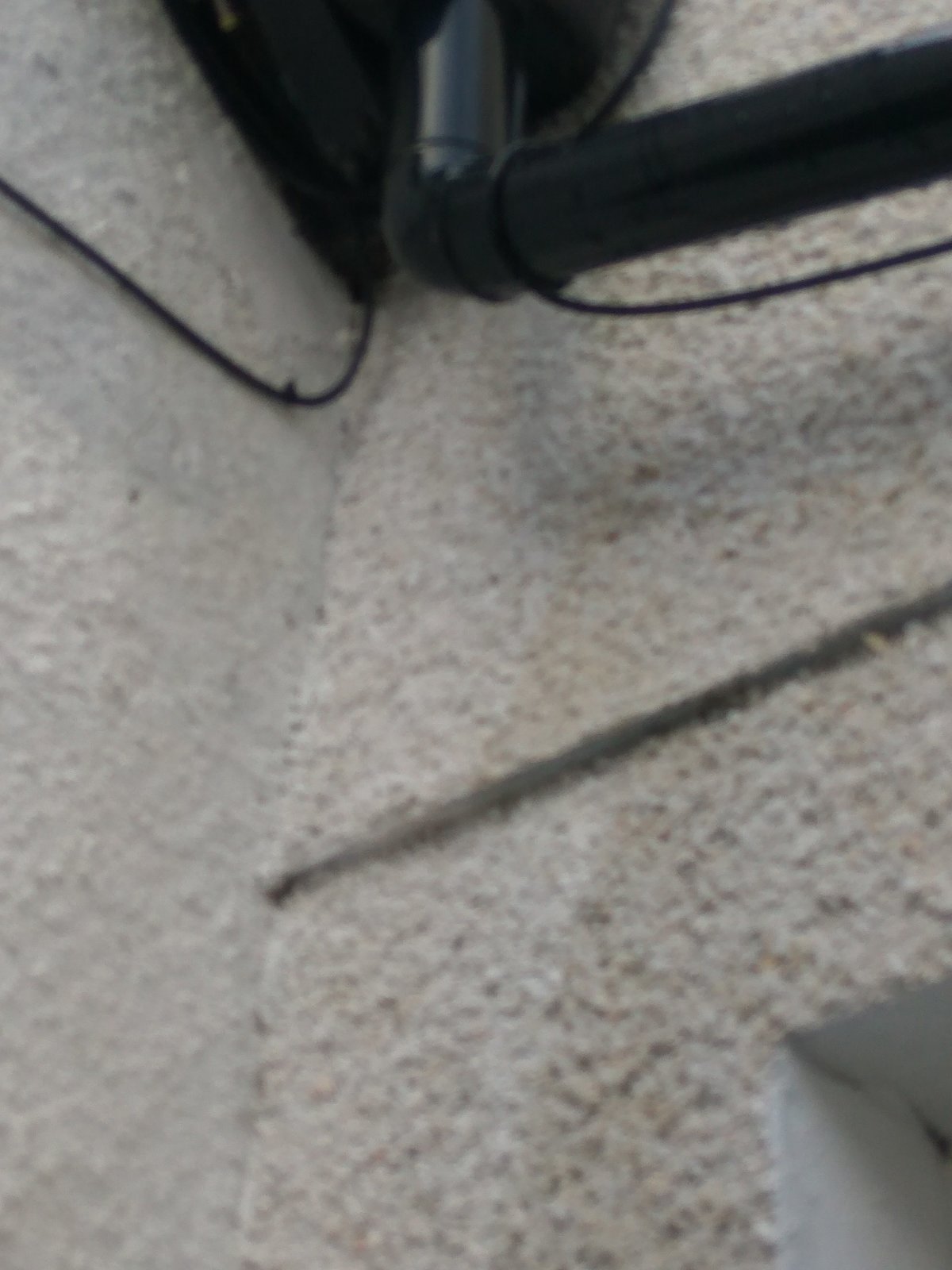

I have a constant drip on a plastic downpipe and wonder how to fix see pic the drip is coming right from the joint piece any help appreciated
Check to see if a hole has been drill to secure the pipes. All you can do, is to inspect it carefully to see where the leaks coming from.
The pictures not very clear, but it's possible that the joints are the wrong way round, so check that aspect as well.
Are the pipes all just push fit and easily pull apart
They obviously do, but if you fit them them right way round, then the water runs down inside the next tube, and if they are fitted the wrong way round, then the water can runs down the outside.
