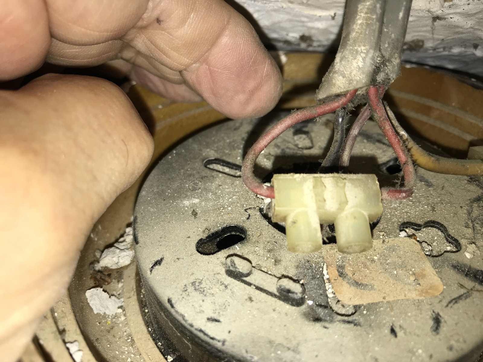

Hi All, this is my first post on here. I can see people have asked this question before but I'll ask again as I want to be certain I'm doing the right thing in my particular case. I'm replacing everything in the bathroom including replacing the ceiling and replacing to old single bulb light with 240v bath/show spec downlighters x 6. I have attached a pic of what was there and a picture of the wiring underneath the rose. I have two cables coming in from the loft with the two earths twisted together, the two reds joined together leaving two wires going to the bulb. I have terminated these two wires and pulled the lot back into the loft while i put the new ceiling up. I will be joining the 6 new light fittings together presumably using the usual 3 core lighting cable but how should I connect that to the wiring I'm currently left with. All help appreciated.

You need to replace the light with a junction box. The cables go in to the junction box exactly as you have them at present.
ie
Two reds connected together and nowhere else. Earths connected together
That leaves two blacks. These will be the live and neutral connections to the downlights. You'll need to find out which is which. Do you have any sort of electrical test meter?
When you have found out, mark the live one with red or brown sleeve.
Then you 'll need new cabling to run round friom one downlight to the next. You'll need 2 core and earth. The earth connection must be carried round from supply to the last light EVEN IF THE LIGHTS THEMSELVES DO NOT NEED AN EARTH!
Neutral to Neutral.
Live to Switched Live.
Earth to Earth.
Make sure you maintain the permanent live loop

Thanks for that Taylortwocities. Can I assume that the earth from the new cable will be connected to the currently twisted pair earths which will shortly be in the junction box?

Neutral to Neutral.
Earth to Earth.
