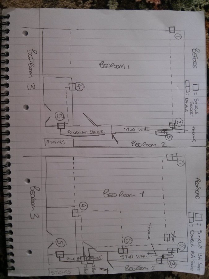

Hi,
Currently in the process of sorting an older style house out and started in the main front bedroom. All the sockets were singles when we first moved in.
My question is:
Is it acceptable to put a separate ring within the main ring? I've drawn a crude sketch to try and explain better as pictures tell a thousand words (so they say)
The original layout of No1 and No2 looked (so far without going into the other room) to have been spurred twice which is acceptable as I understand but I'd like to put double sockets there where the singles are now which I can't do.
The proposed drawing puts No4 and No6 (which isn't there yet) into a ring within the ring so to speak and the spur off No6 to No1, would that be OK or would I have to put No1,No4 and No6 into the ring?
Looking to get some of the Hager 30A 3 way Junction boxes to do the job.
Any guidance would be appreciated

Why create a figure of 8 (ring within a ring) when you can simply omit the link between sockets 4 and 6 and do it properly?
The link between 4-6 isn't there on your current drawing, so just don't put it in?
No! The reason is because should the sub-ring from the main ring become broken, any tests done on the circuit at the DB in the future will show everything is ok when it is in fact not.
Essentially by creating a figure of 8 configuration (ring within a ring), you can't tell from the DB if one of the rings within a ring is broken.
What's my options then eveares?
Either break into the ring and put them on it or could I use separate JBs to each socket from the ring main?
Cheers
Your BEST option, is to make it a proper ring with no Spurs and no JBs.
Second best is to spur off the ring - once from each point on the ring and avoid JBs.
Third and least preferable is to use JBs.
As you're aware any JBs would need to be MF.
You can extend the ring in the back of a socket if that helps you out, you don't need to use a JB

Clearly you can break the rules, however to keep within the rules any new socket must be RCD protected but there is no requirement to up-grade those which already exist. The existing sockets only need to comply with the rules in place at the time they were done. So nothing says you must change the fuse box for a modern consumer unit, but it is nearly impossible to extend a ring without first changing the fuse box if you want to comply. However using RCD FCU you can fit fused RCD protected spurs clearly limited to 13A total.
Once the fuse box is changed for a modern consumer unit all those RCD FCU are redundant. So to add an odd one OK but to add many would get silly.
In theroy you could replace every single socket with a RCD FCU feeding a line of sockets and it would still comply. The PSC current for the 30A fuse is far higher that that required for a 13A fuse so very unlikely using RCD FCU you will not comply.
