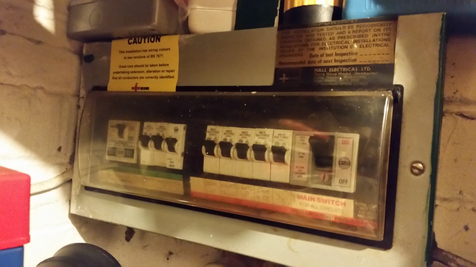

I persume I couldn't just have the rhs mcbs replaced with RCBO's then, it would be a new Consumer Unit installed?.
Thanks for all your help/ time!.
If there is enough height to the CU for RCBOs to be 'easily' installed, then that would be a theoretical possibility - although RCBOs are so much more expensive that MCBs that such an approach would probably not make sense unless you actually wanted RCBOs (which is not a bad idea!). Some would probably argue that doing that would change the CU enough that it counted as a replacement one, in which case it would have to have a metal case - but it looks as if yours might already be metal?
On balance, I would personally think that it would probably make more sense to get a new CU - either dual RCD or 'all RCBO'.
Kind Regards, John
Thanks John, all RCD protected would be nice so it looks like I'll have to start saving the pennies!.
Yeh it is a metal consumer unit.
Main concern is the metal light fittings and metal oven are not RCD protected at the moment.

A dual RCD CU (covering all circuits) would currently be quite a lot cheaper than an all-RCBO one - MCBs are typically £2-£3 each, whereas RCBOs are generally over £20 each (and RCDs perhaps about £30 each).

If you decide to go for a new (or even just 'refurbished with RCBOs') CU, any decent electrician would do fairly extensive tests of the installation before touching the CU - so you could thereby avoid paying separately for an inspection/testing.
