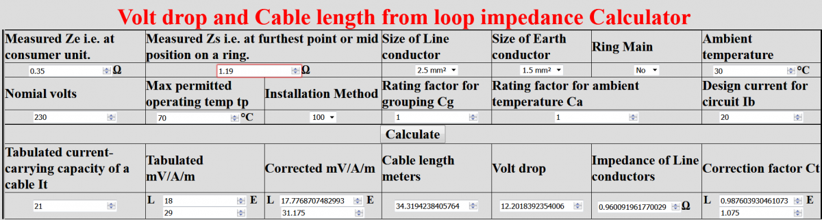

He wouldn't go into any detail, my only test was Zs of 1.16Ω, 1.17Ω & 1.19Ω which felt OK for something as small as B20.

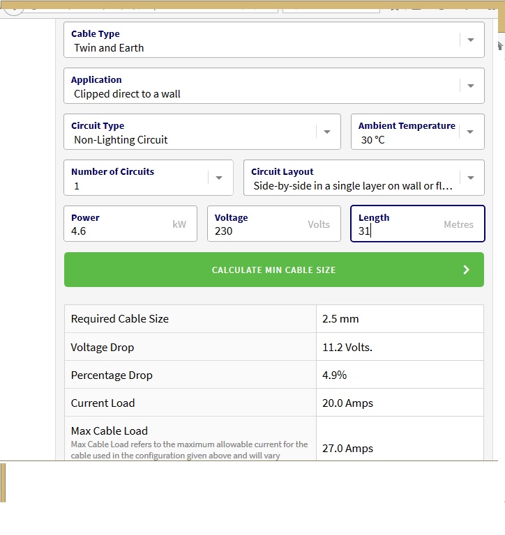

These are the supplies for the stage lighting which most certainly does not get restricted to 16A, the 3 dimmer packs we plug in are 4 channels of 10A and have 32A plugs mounted on them, the largest fitting we have is 650W so pack load will not exceed 2.6KW 11.5A.
My online calc shows this socket arrangement is good to 31m
and these are nothing like that length, in fact the R1+R2 at installation in 2006 are: 0.42, 0.43 & 0.42. Assuming 1.5mm² CPC this is a very realistic 23m.
The only thing that has changed is having 2 SSSO in place of each DSSO but I do share your concerns about missing something and it biting you later. I learnt that one the hard way in panel building:whistle:
