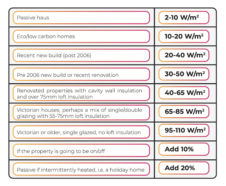

OK, in that case the first thing you need to know is your incoming mains pressure & flow rate. That will give you some idea of the hot water performance you can expect and thus help to inform your choice of boiler.
You also need to know the heat loss for your home (IE how much heat it actually requires, which is almost certainly less than you think). Since June last year it has been a requirement of Building Regulations in England & Wales to carry out a full heat loss survey in order to determine the most appropriate boiler power for a property.
You can get a good approximation yourself using this handy chart
Once you have these two facts, you can start to choose a boiler. I'd suggest looking for one that accepts OpenTherm controls unless you're happy using manufacturers own modulating controls
I'd say we are in the 40-65w/m2 bracket having cavity wall, 200mm loft insulation, solid floors and upgrading all of the rads with TRVs and convectors (75 % done)

89m² old side @ say 50w/m² = 4.45kW
14m² new side @ 30w/m² = 0.42kW
Total heat load therefore about 5kW when it's -3°C outside with an internal target of 21°C. Heat loss is a function of the difference between internal and external temperatures, and as such on a day when it's 9°C that heat load will drop to 2.5kW. Now you'll hopefully see why modulation is important.
13l/min points to around a 30-35kW combi.
