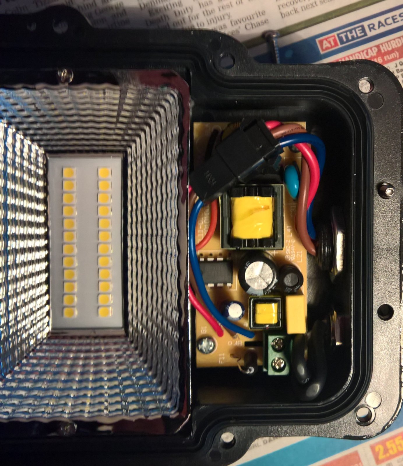

hi guys I have a few of these at home ansell carina security lights 10w with pir, just asking is there any way to disable the pir so it on from dusk till dawn, I just looked under the pir all I see is timer and night to daylight logo, with replace it or use a day night switch is there any way round it
The units are always an integrated PIR + Photocell. So, You will need to get a separate photocell and wire it in to the light itself, bypassing the PIR.

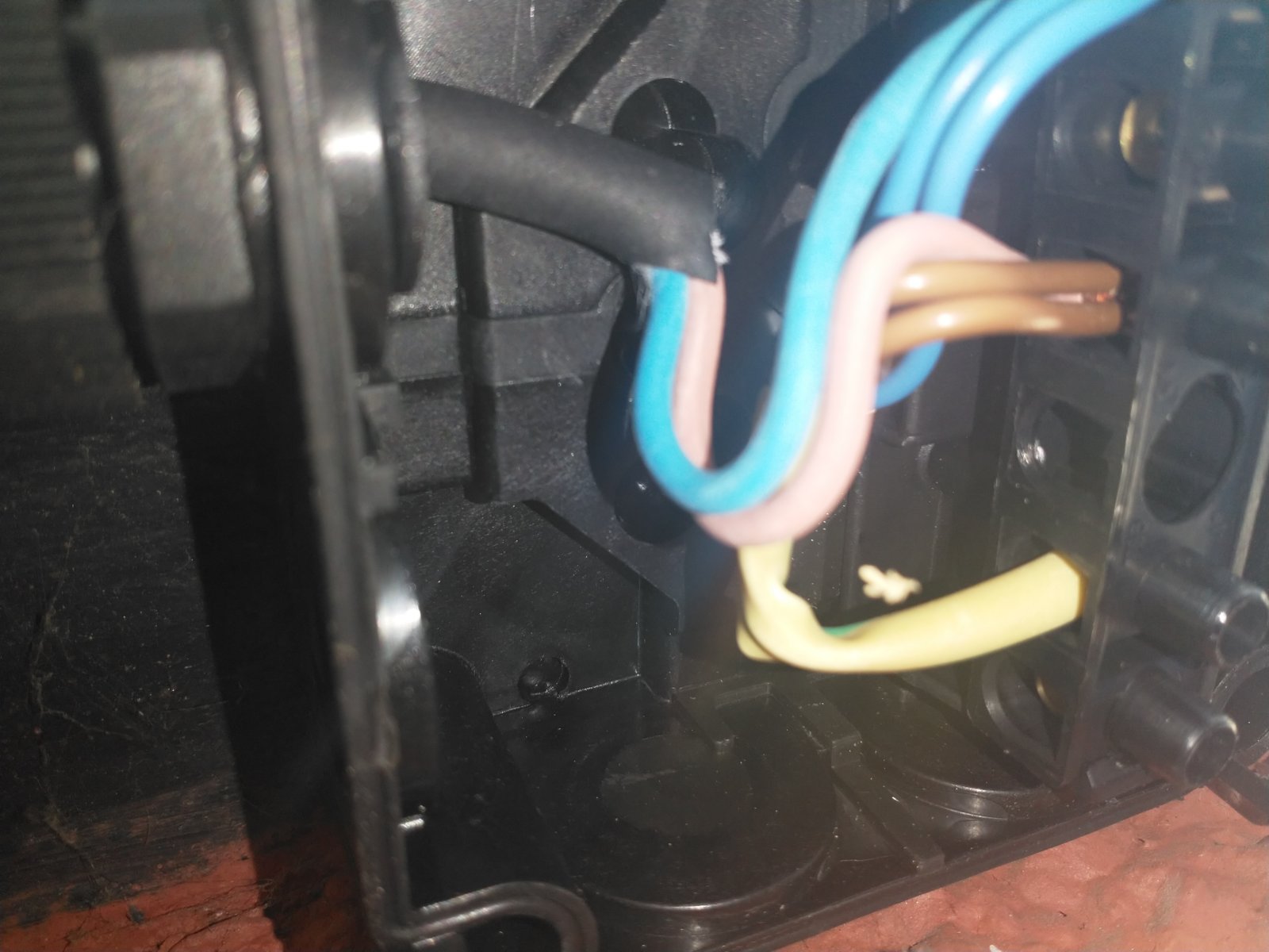

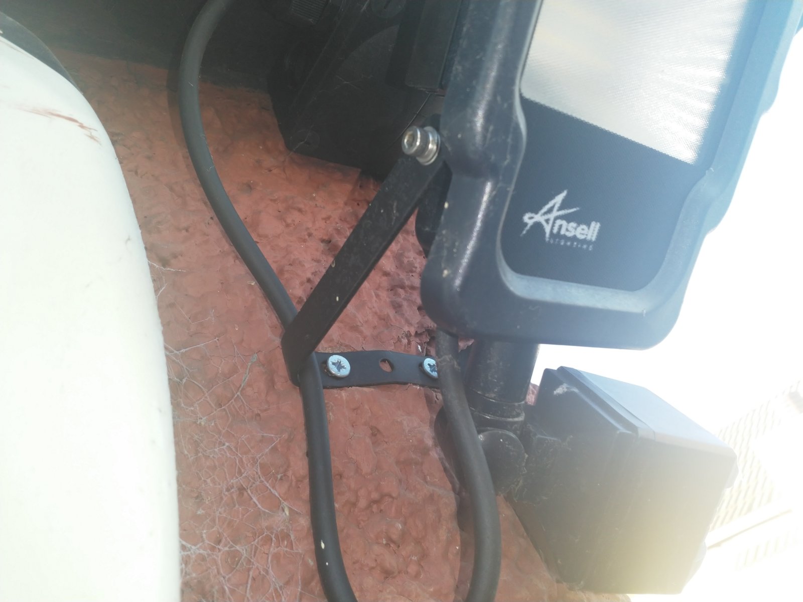

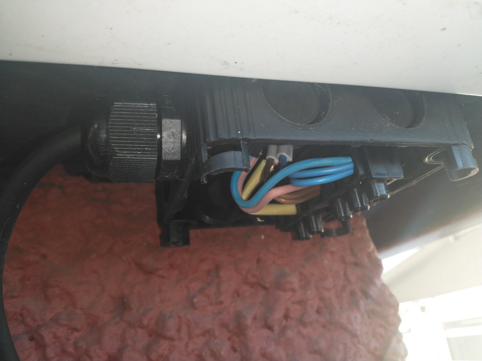

Some makers lights bring the lamp connections out to a terminal block. Post a pic of the wiring at the back of the light.
Not sure if clear enough to see

I suspect it could be a pre-wired 3C flex jobbie and that’s the only terminal block available.
I could be wrong
See how I get on tomorrow, but might be easier to just replace both, but I will have a go, going dark now here
The only terminal block we can see is the one in the Wiska box which someone has screwed to the wall behind one of the lights.
