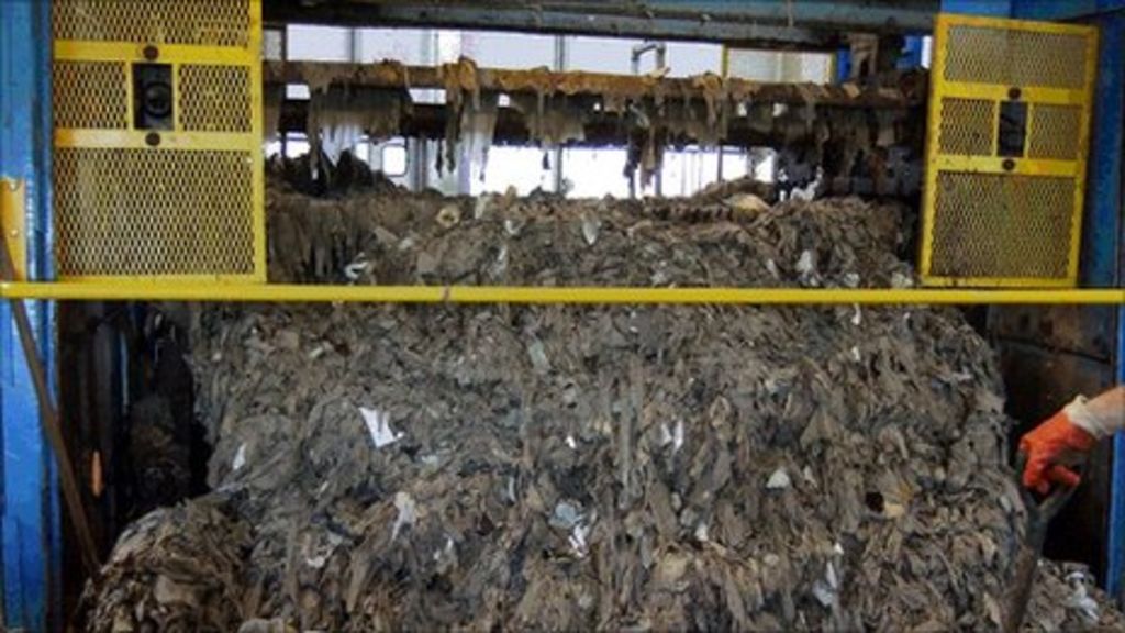

The manufacturers of these wipes market them as 'flushable', which they are, so far as they'll disappear around the U bend when the chain is pulled on the toilet. However, they are made of seemingly one of the toughest materials known to man, as they simply do not break down once in the system. Those that do find their way through to the treatment works are screened out on arrival, and sent for landfill. Its those that dont that cause the problem....
These wipes bind together, and clog pipes, valves, and pumps. Net result is something like this...
