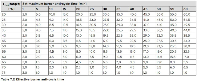

bit of both (but based on flow) for one manufacturer

In simple terms, Anti-cycling mode is the delay in time between the burner switching off when the boiler setpoint has been reached/exceeded and the burner re-lighting, even though the flow temperature may have dropped well below the boiler setpoint in the intervening time.
It's usually built into the boiler controls, and non-adjustable...though some boilers have it as an 'installer level' parameter.
