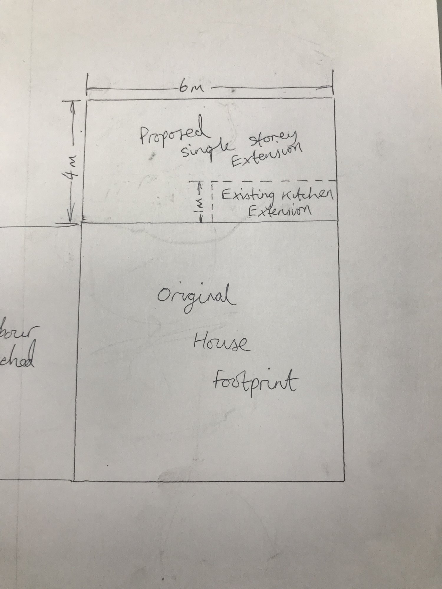

I’m in the early planning stages of a single storey rear extension on my 3 bed semi. I’m going to be self building, pretty much from the ground up. It’s going to be the full width of the house, so about 6m and 4m out so within permitted development hopefully.
My main hurdle before I get architects/engineers involved is to get the plan straight in my head. I’m fine with a traditional block and brick build, but I can’t seem to shake off the idea of SIPS. Other than internet research and some YouTube vids, I have no practical experience with them. Can anyone advise on what foundations they require? My ground is firm clay, and there is a sewer running under where the extension will sit, which I will be getting buildover permission for. The appeal of potentially no traditional footings and speedy erection (ooo err) is massive! Also, the ubiquitous bi-fold doors will be required, so do they require steelwork above, or just a heavy duty lintel?

Be very careful with permitted development rules -is the rear if the house flat across the 6m?
There is a old kitchen extension already that comes out 1m halfway across the rear.
Thanks for the responses. As I said, I’ll be getting calcs done and building control involved. I just want to get as much of it clear in my own mind first. I might do timber frame. As has been said, brick and block would probably be cheaper. The speed to water tight stage is what appeals, but then you have to issue of cladding and the junction between new and old
Be careful of the side extension rules -maybe post a simple plan drawing / sketch on here for some feedback in case its not PD.
