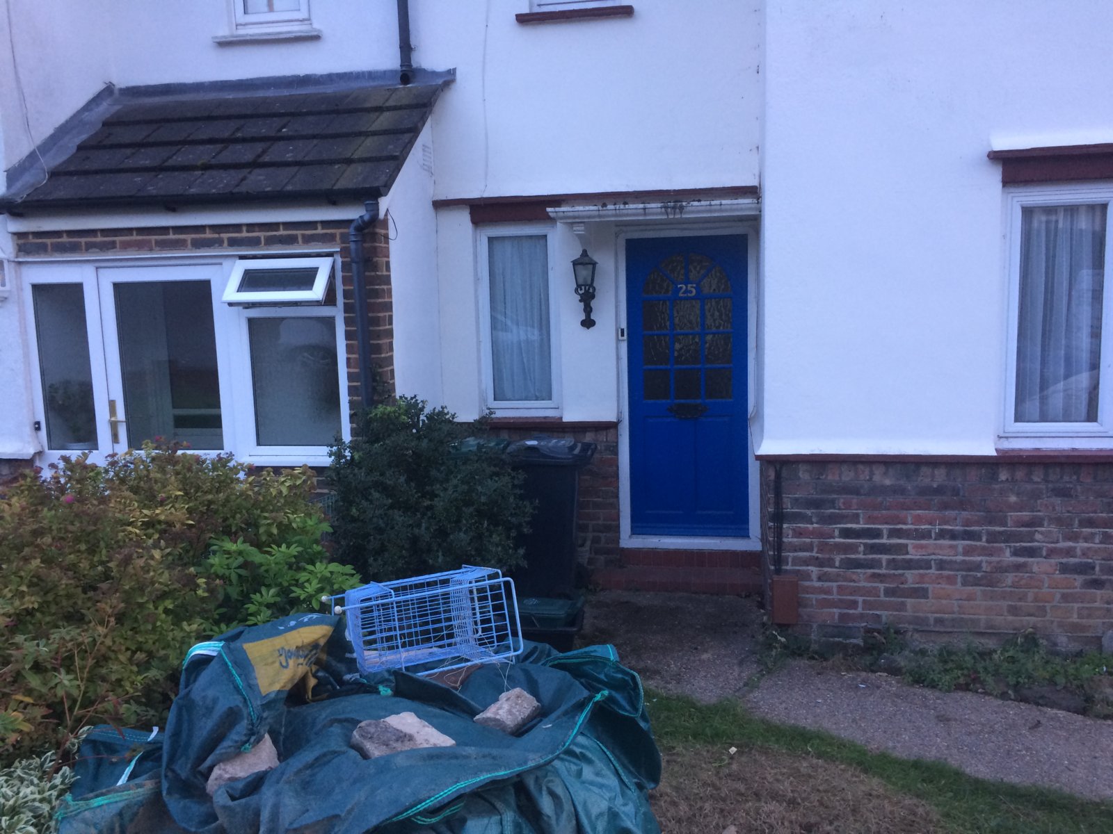

SIPS panels are useful for professionals building whole houses, but are they any good for DIY on a small porch? I can ask the panel producers, but I suspect their advice will be biased, and a couple of hours searching the internet left me none the wiser.
I'm a competent DIYer and feel up to doing everything apart from brickwork (I've done it for gardens but just can't get mortar to behave) and the electrics (I'm very capable but not certified (don't believe my ex-wife)).
Details of the Idea.
I'm looking at a porch with one new wall, a roof, an entrance door and a window panel.

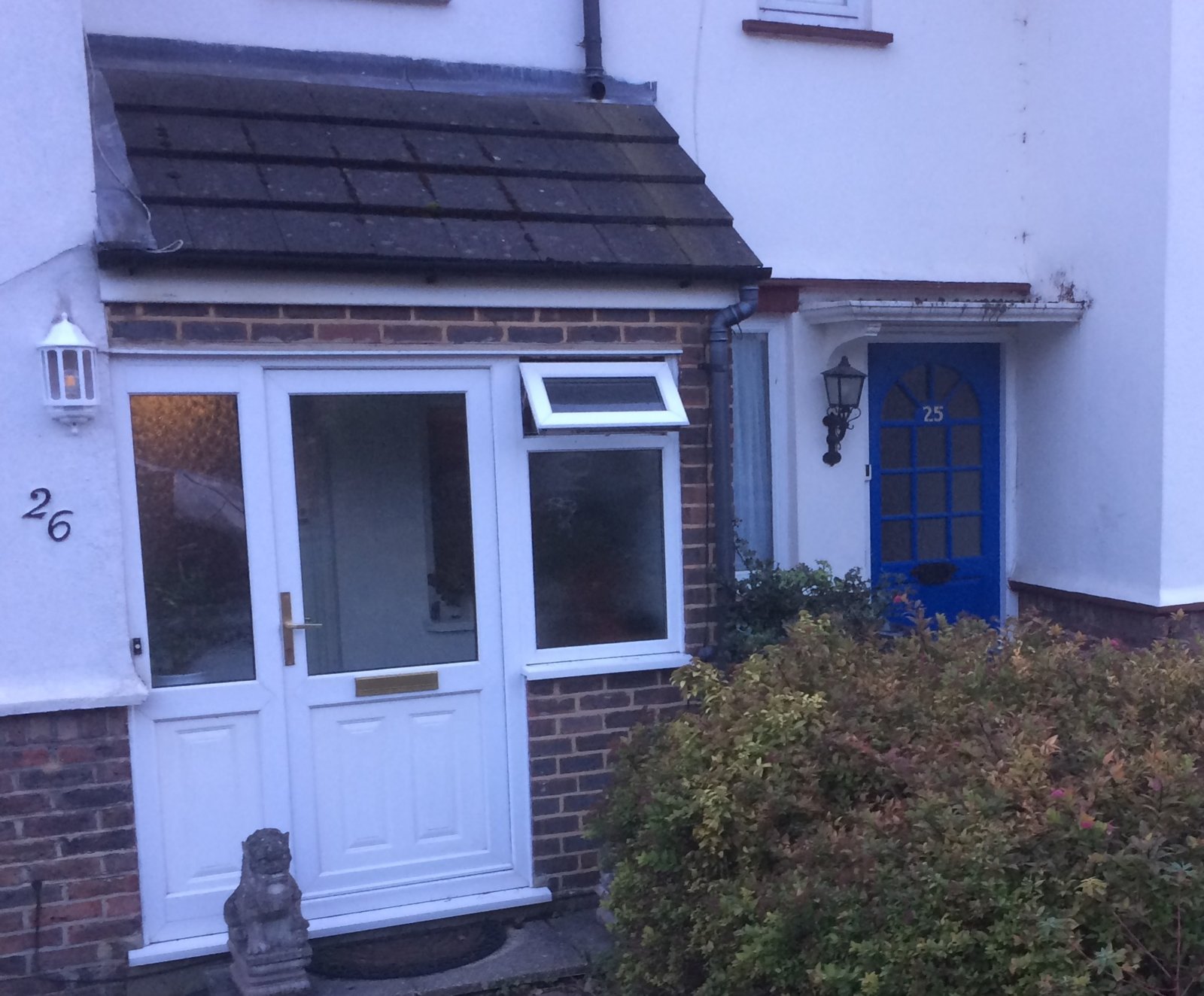

The images show my (North-facing) house on the right and my neighbour's porch on the left. Essentially, the previous owners agreed to have a joint build then pulled out, which explains why the party wall straddles the property dividing line and their roof overhangs our ground. I'm looking for a broadly similar porch to fill in the 1.2m x 2.1m floor plan, matching the brickwork and carrying the roof over.
I'm not expecting any admin/legal issues. The neighbours are happy and will give formal party wall consent. The house has had no development so the porch is well within permitted development limits. I'm keeping the old front door in place so, in theory at least, I can be relaxed about Building Regs.
Why am I dithering?
Moving past the obvious answer of my being indecisive (but am I really?), I'm unimpressed by my 2 main options of a single skin brick structure (cold in winter, so of limited use for storage of coats etc, and often picked up on sale surveys as 'a problem') and a double skin insulated structure (300+mm thick, so takes out a big chunk of the available 1.2m), and SIPS panels with a brick slip outer covering might offer insulation without taking up too much space.
Furthermore , it all seems a lot of work for not much space so I'm still open to forgetting the porch, fitting a modern composite front door and building a larger door step with drainage (the area gets flooded easily), possibly also replacing the old concrete overhang with a roof to match next door's.
