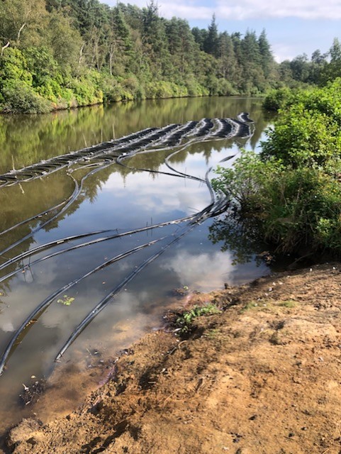

any one got a lake
20 Nov 2009
39,368
5,186
Surrey
or big pond in there garden plus a quarter of a million kicking about ? than you can heat your house
obviously the pipes have been sunk to the bottom of the lake now
tis the future eco heating :)

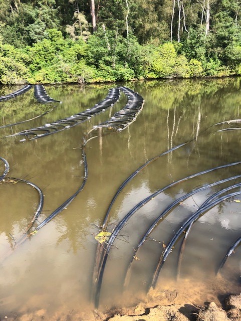

How does sinking them to the bottom help them to heat up? I would have thought having them at the top they would be warmed by the suns radiant heat.

It's a water source heat pump. Instead of sucking heat out of the soil you suck it out of a lake. It's much more efficient than using soil.
Water in lakes is odd, when it's cold the top layer freezes but the bottom stays warm for a lot longer. Don't forget that these only get used when it's cold outside after all. I don't have a degree in thermodynamics either so I can't tell you why, but it does.

no they need to be at the base of the lake in the sediment

it’s going to heat a 235 year old mansion
insulation was not really on the agenda 235 years ago when building houses
it’s replacing an oil fired system which was working at approx 70
this set up will produce 53 degrees
