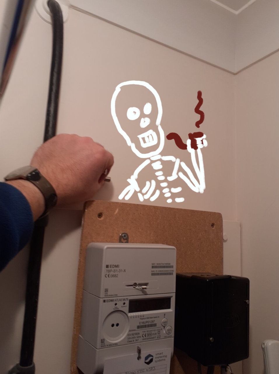

Putting brackets up in this wall. Above rail It's plasterboard. Any pipes in it? I'm checking with detector and magnets. Above the electric board the magnets are being pushed away from wall rather than attracted in, electricity present?
A magnet will only help you find iron and steel, cables are copper. The only things able to repel a magnet, are another magnet, or a solenoid running on dc. Your mains cables operate on ac.
A (metal ?) detector might find cables hidden behind the plasterboard, but there is no certainty. The only way to know for sure, is with the Mk I eyeball.
Well my cheapo detector found nothing to the left of the electric board but was buzzing non stop above it. No metal detected at all. Magnets picked up nothing- was hoping to find the screws in studs. I wont put shelf above electric board just over the rest. How about duo 6mm plugs in 5mm drilled holes, will they hold brackets and small shelf? Or will have to be plasterboard fixings?

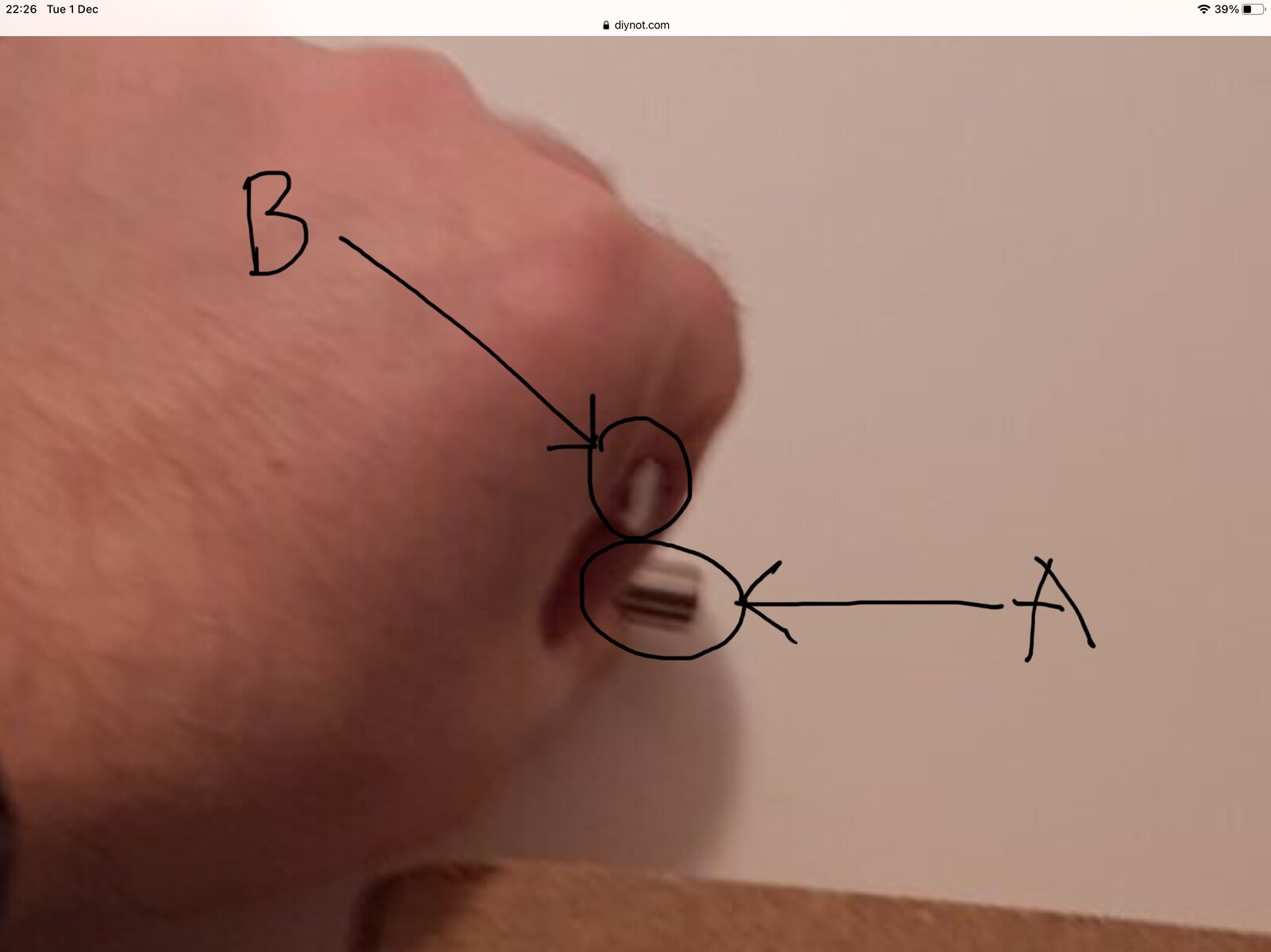

The magnet you’re holding against the wall A is being attracted to the magnet you’re holding in your fist B, giving the impression that A is being pushed away from the wall.
