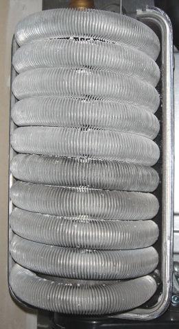

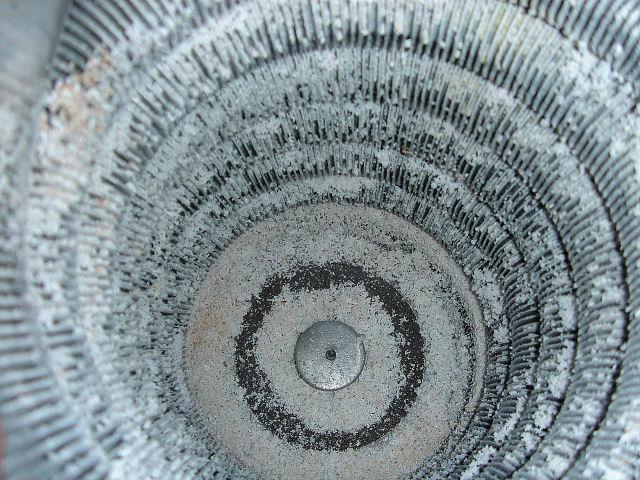

This is the heat exchanger on a Buderus after just ONE year. I hadn't even removed the lower baffle yet since it was stuck until some preliminary cleaning was carried out. Ok it's a different boiler but if the conditions are right you can get a lot of deposits.

F/h**l Gg, thanks for that. Have fitted one before and was worried about alloy and Buderus is supposed to be the best of them. Thankfully gone back to stainless for some time now and found pretty clean on servicing.
The system had been setup to condense as much as possible (very oversized rads etc and low DHW temperature). The deposits brushed off fairly easily and the outside was fairly clean. These are cheap anyway ..about £90 last time I enquired....most other heat exchangers wright the boiler off.
