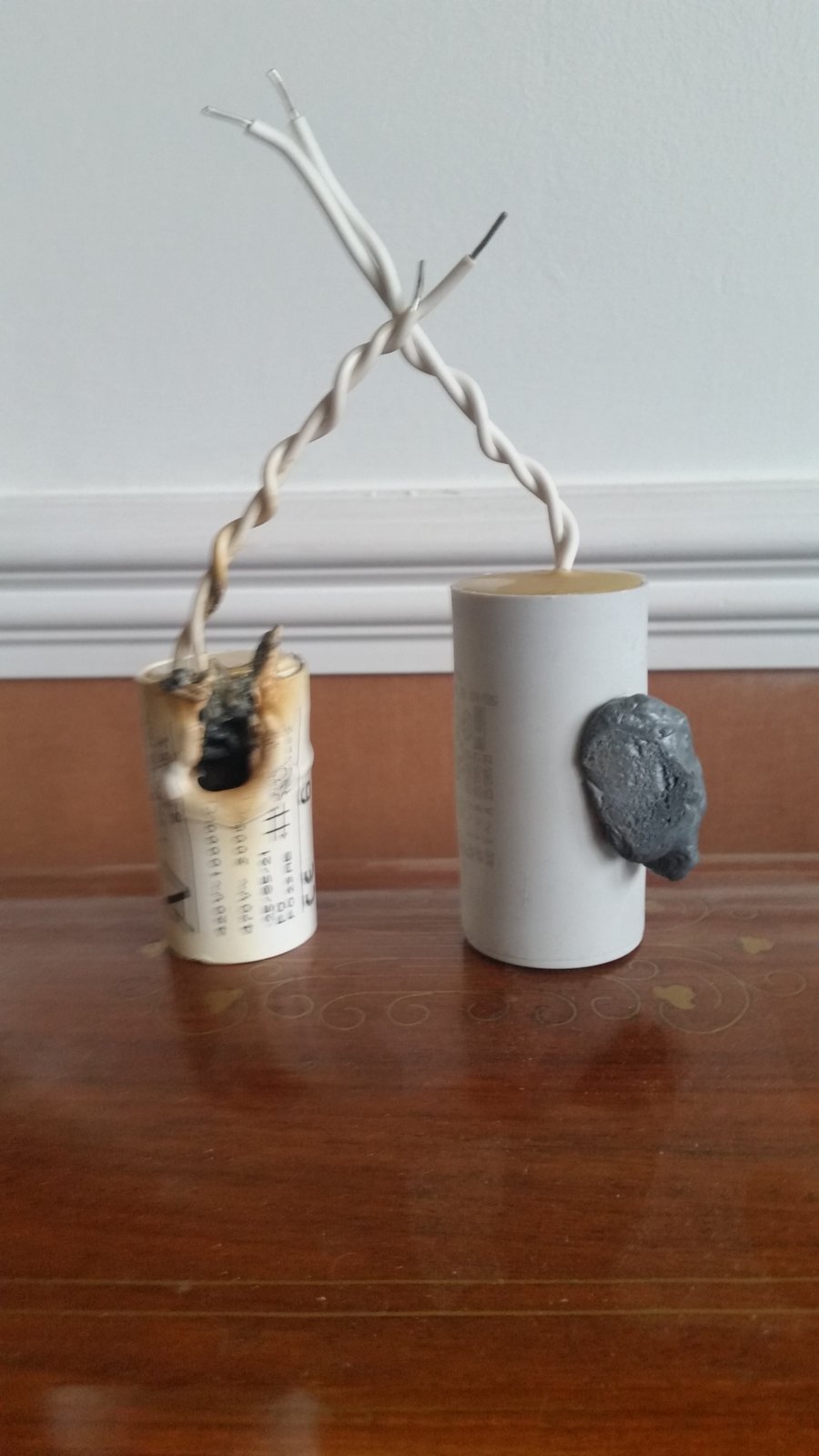

Thanks. So the capacitor is just for initial sartup and even if it’s knackered and buzzing/humming, giving the blades a flick with a screwdriver should get it going?
Perfecto! A buzz, a little flick and away it went. :mrgreen: Thanks a million mate. (y)(y)

Top tips : Fit new capacitor and test before assembling. :sneaky: And the end nearest the micro switch on the base plate goes in the chamber first (if you look there are lugs inside the chamber and the switch must go under these or the base plate wont go fully home). Securing ring has a chamfer this must face the bottom of the tank.

Do the test first and if it is the cap then see what size it is before buying. Depending on age it could be 10 or 14uf.
