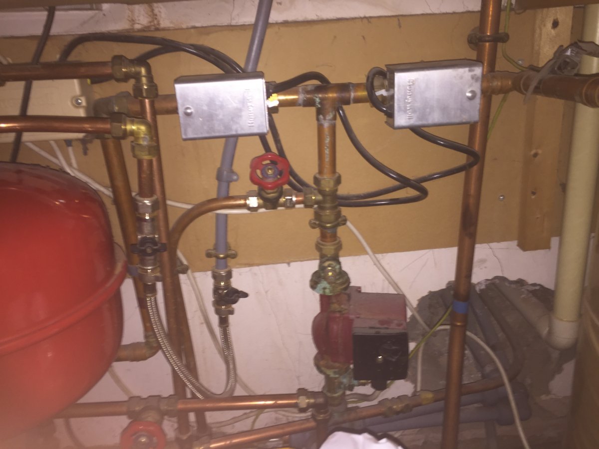

We recently moved home - into a property that has a 'dated' hw/ch system. We have an issue with what i think is a 2port honeywell valve - where the central heating is not firing the condensing boiler.
Over the last couple of days the valve has been making a buzzing noise and simply not turning heating on. The hot water still works - and i read online that if i hook the manual lever on both to on position then this will push the water through the radiators - but doesn't seem to work for us.
The pipe at each side of the valve gets hot but for some reason no heat goes through the system :s
The tanks/ condensing boiler are being replaced with a combi next week so not looking to buy anything to fix it - but was wondering if anyone knew of a temporary fix we could try to get some heat in the meantime
There is no thermosat just a programmer on the wall
Thanks in advance

Moving the heating valve into manual by-pass might not bring on the boiler depending on make of valve, try manually opening the heating valve and then switching the HW on and see if the rads get hot, they will go cold again once the HW is satisfied though
There are 2 honeywell valves - and its a Worcester condensing boiler - how do i manually open the valve? - i look the cover off the box but there was no place for a spanner to go - will upload a photo
This is in the cupboard - the one on the left was the one that was buzzing

there is a lever on each valve, do not take the cover off, the leavers are visable in your pics, you just push them and lock them into position, this will allow flow to your CH but will not bring the boiler on, you will have to select water too in order for the boiler to fire
My apologies for being stupid what valves in the pic? - i move the levers on the metal valves before and hooked them both open but even with hw on no heat came through radiators
moving the CH valve and hooking it is what I mean, but this will only open the valve it will not signal the boiler and pump to run, you need a demand for hw in order for the boiler and pump to run, if the hw is satisfied it will not run

Did you check the valves on the other side of the radiators are also open (lockshield valves)? If there is hot water flowing through the pipes on both sides of the 2 port valves, the square metal box topped valves in your pic, then the valves are open and working but if there's no heat at the rads then first thing I'd be checking is that their valves are open.

Rab, regarding the valves on the radiators - we havent touched these since the ch was working at the weekend - so id presume they are still open - the only ones we have fiddled with are the thermostatic ones
