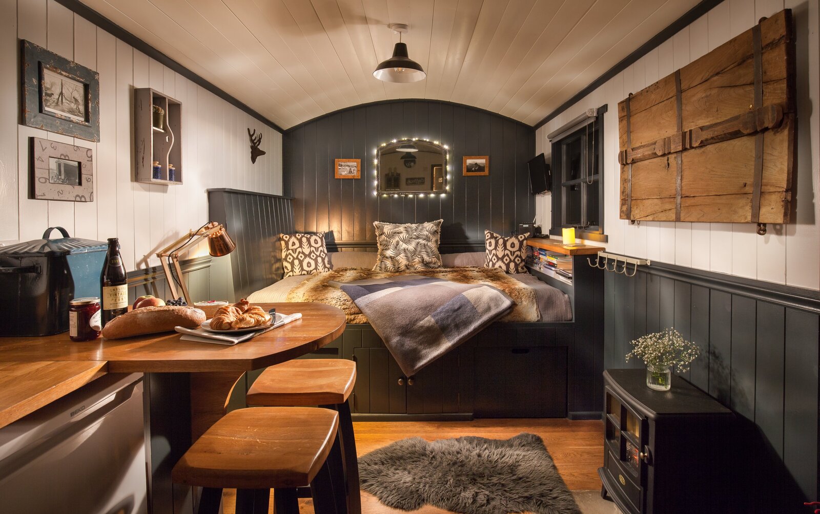

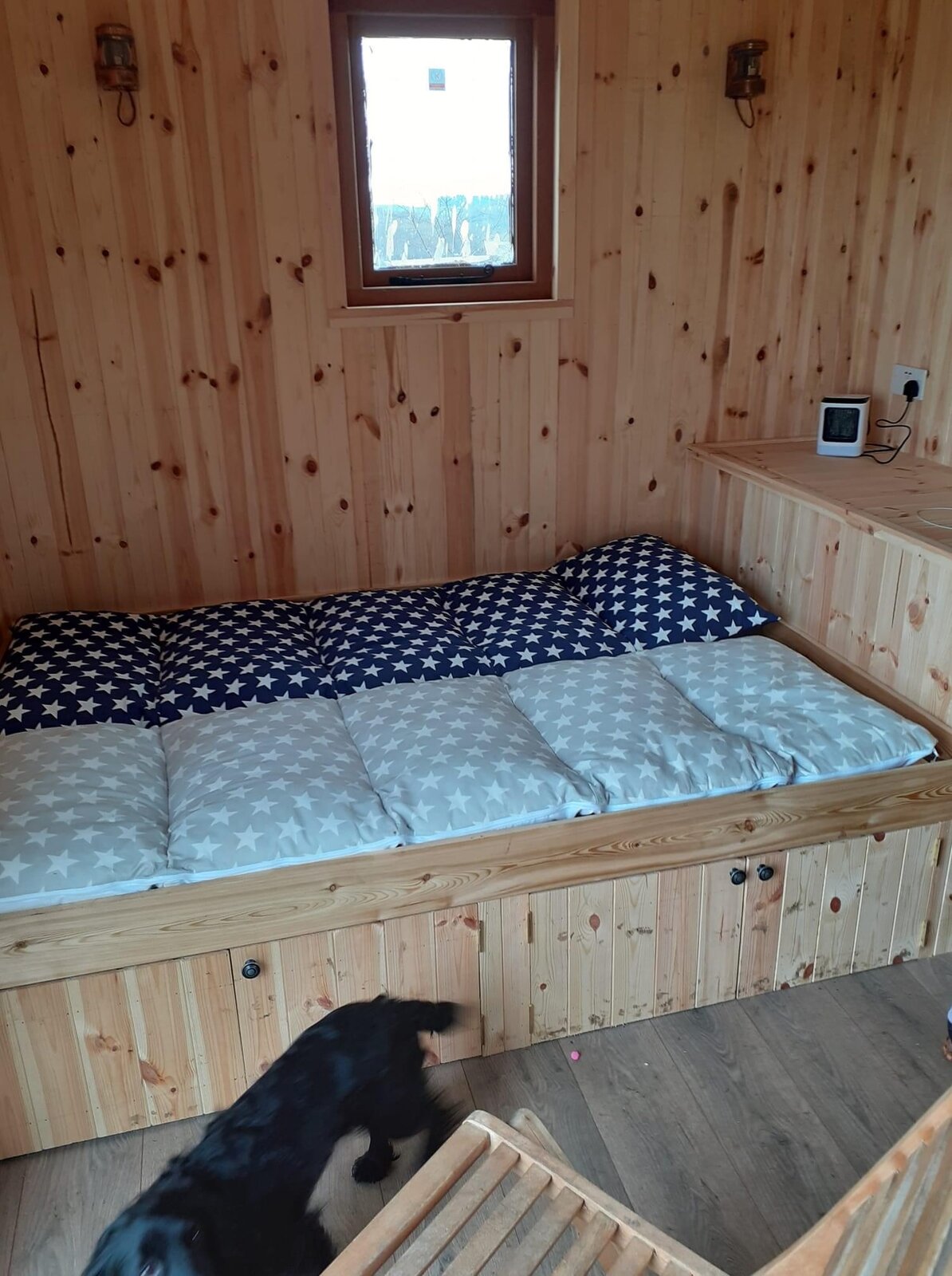

    08B20921-EF74-4D11-B9B0-9E340C263780.jpeg 22C745E5-FA34-4E64-B5B5-1B50ACBC6A96.jpeg Hi all I’m about to paint over the pine tongue and grove? In a Shepards hut and wondered if anyone had any tips or suggestions that they could share. Are the knots likely to bleed through or is it presealed? The guy I bought the hut off recommended using a vapour barrier paint?
    Any suggestions or paint recommendations would be helpful. (Ideally Johnson’s paint if poss)
    this is now and what I’m aiming for..

    You will need to treat the knots. I have found Zinsser BIN best it is shellac based with methylated spirit as the solvent, unlike standard knotting it helps to cover the dark knots and gives a white base.
    Only down side is it is very fast drying, so don't over brush too much and keep good ventilation if you don't want to get high on fumes. :eek:

    Thanks very much, appreciated. I've done that today and am now considering what paint to use inside to cover the pine... Do you have any recommendations please? I was considering using Dulux Ultimate opaque, but am now off put after reading that you require a couple of coats of aquatech prior to painting. Is there anything good quality that will go straight on? Many thanks ;)

    To get the nest finish best not to take short cuts. BIN can be used as a single coat primer on just bare wood if required. But certainly a good idea to over coat any knots again as belt and braces. I have had good results with Johstones Aqua satin paint it is important to use their undercoat though and follow their instructions. Use a synthetic brush damp the brush first and wipe over the area to be painted with a damp cloth just before painting doing a few planks at a time to avoid the usual trouble of brush marks with quick drying paints.
