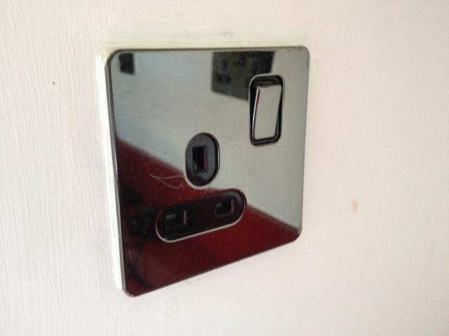

Anyone know how to get the front off this?
Hi all,
In the house I'm in all the kitchen sockets are like this...
There is no visible screws etc.
I presume they are stuck on with sealant or something??
But I just wanted to see if anyone had come across anything similar and whether they could advise how to remove them??
I don't want to damage the socket front as I remove it.
Many thanks
John :D

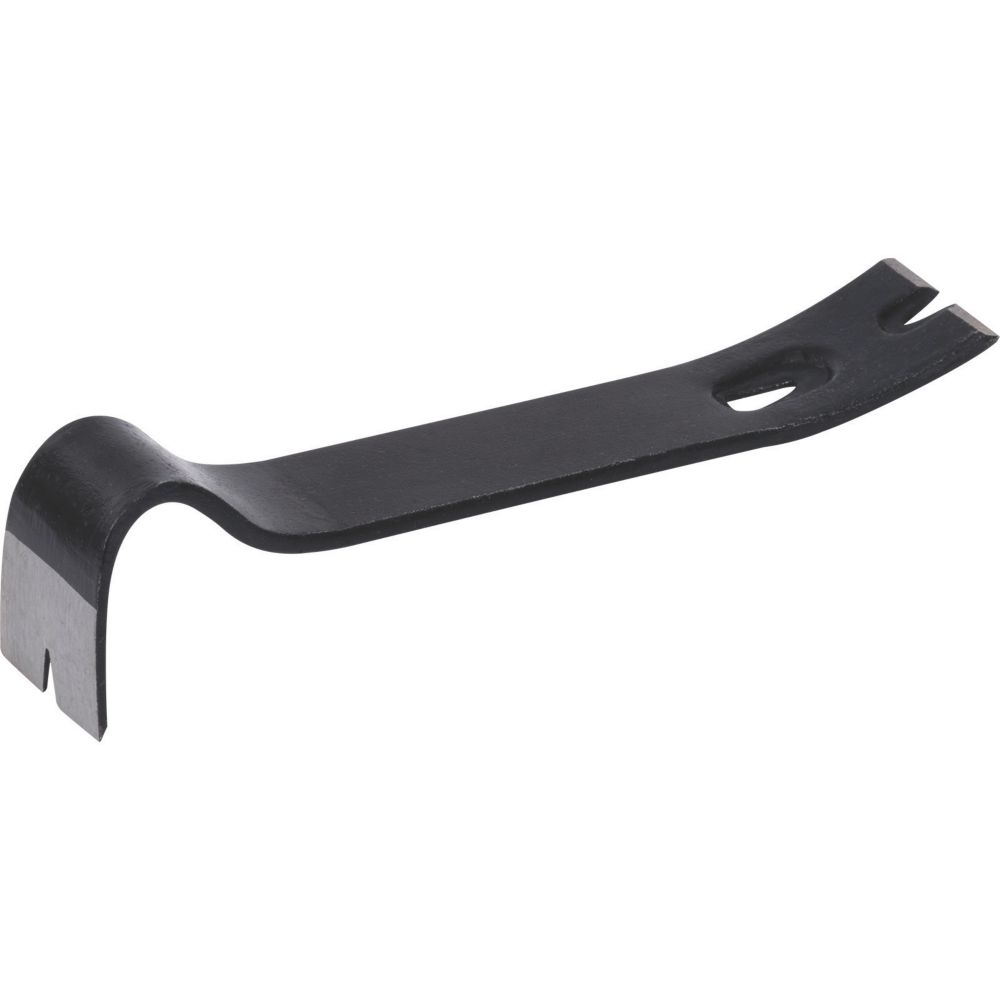

best thing for those mate is a 50mm wall paper scraper ....
Thanks for all the great replies to this topic.
I managed to remove the front yesterday and do the job. It just pulled off and was held on with 2 clips.
The actual socket was a special type to allow the fitting of this front (i.e. it wasn't retro-fitted to a normal socket).

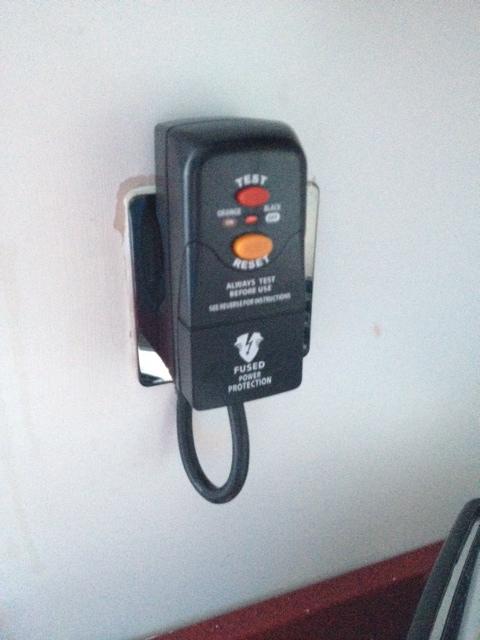

The socket is fed from a 16A breaker (standard 2.5mm cable) in the distribution board. Then, in the socket is this....
Which then feeds the outside socket.
I don't think there's any issues with this at all.
What do you think?
Cheers
John :)
