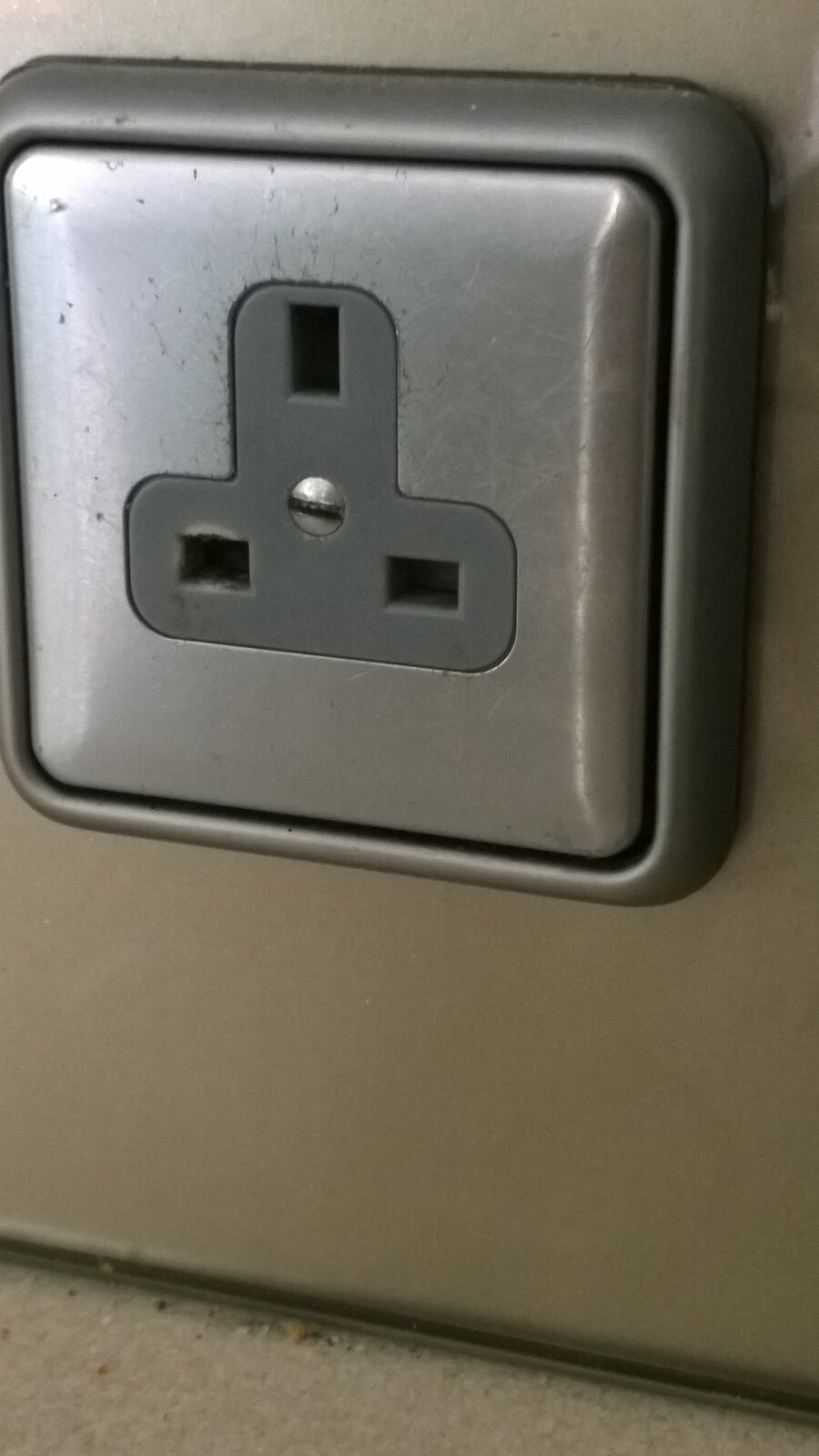

Can anyone identify this socket outlet
10 Jul 2005
9,038
1,650
Lancashire
This socket was installed in a Wren kitchen a couple of years ago.

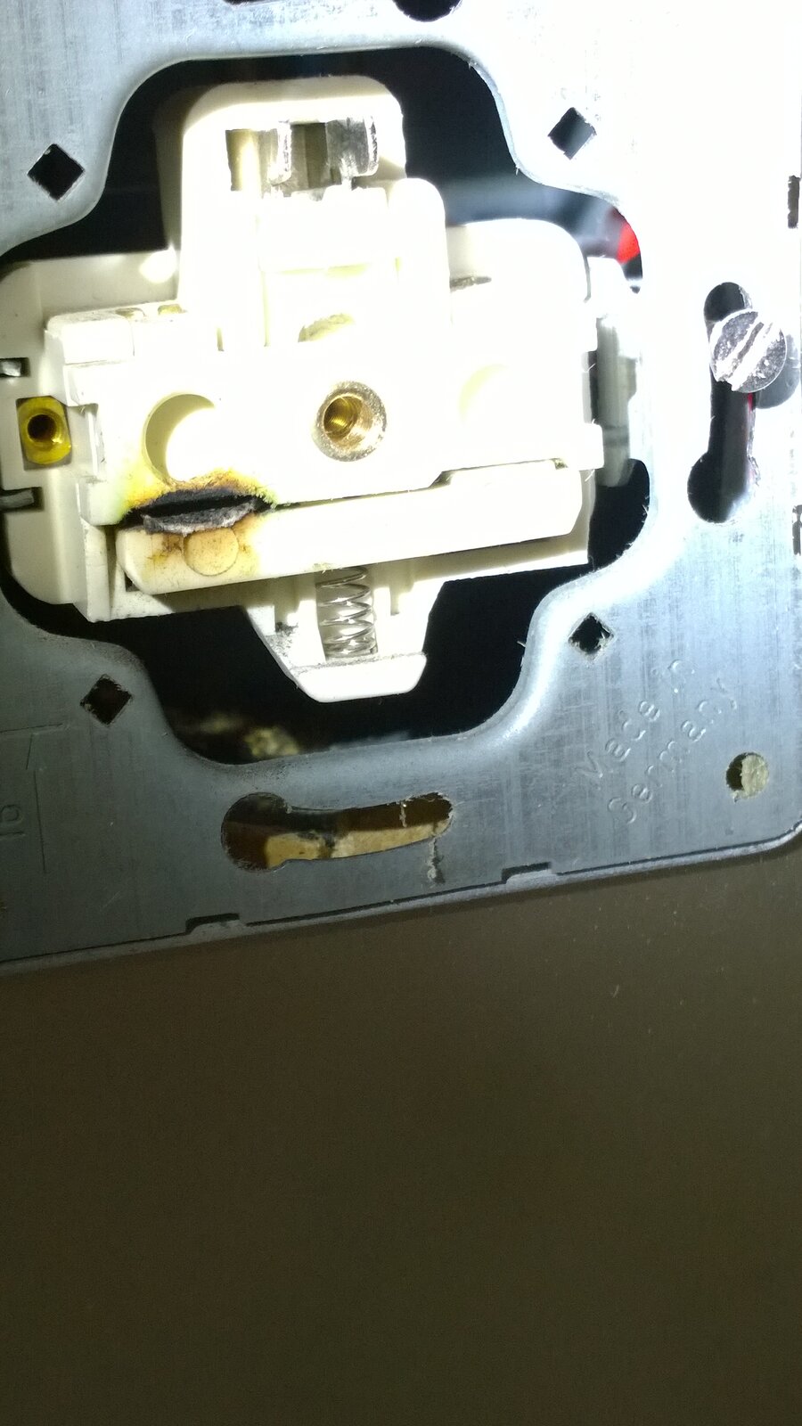

A few days ago the householder noticed the 13amp plug was hot and difficult to remove.
The terminal are all screwed up tightly in both the plug and the socket outlet.
If anyone can identify this I would be very grateful.
The only marking were Made in Germany" on the metalwork
Replace it with a known good brand and not that make as it seems it only lasts a couple of years.
I agree about a know brand but the customer wants it to match the others in her kitchen
What puzzled my is that they are all single gang and not doubles
if you are sure the fault lies with the socket, and not with, say, the plug, then she'd be better advised to change all of them to a more reputable brand. At least they will all match then.
Do you know what was plugged in to it?
Apparently it's only ever had a kettle.
I suggested she stopped using this socket because if a plug locked in due to the L & N pin insulation melting it would be impossible to get to the central screw to get into the works
