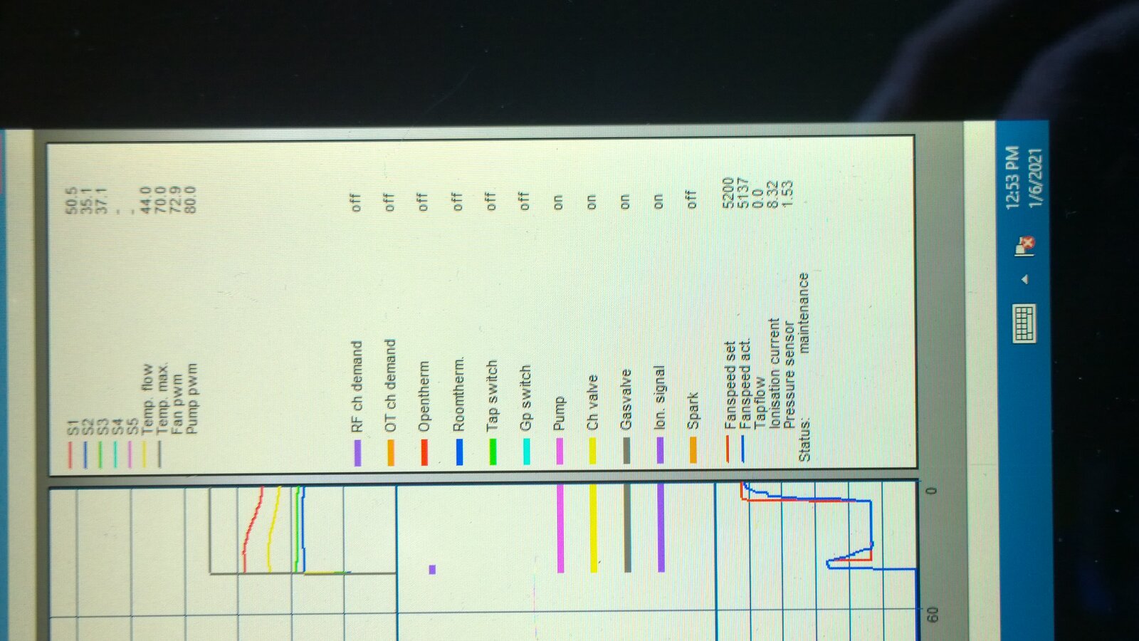

I got called out to a new install.
Over the phone the installer said this Intergas Combi Boiler would work OK in When running hot tap but would keep locking out on Central heating.
The boiler was temperately using extension to supply electricity to the boiler.
I plugged my Tester into the socket of this extension which indicated an earth fault.
On examination this extension lead had only two conductors.
I replaced it with a new extension and the boiler ran OK.
When running the Manufactures Software with my lap top connected to the boiler the display was showing 5.9 at 1300rpm fan speed and 8.32 at 3200 rpm once I had connected the new extension cable.
The later Boiler PCBs have been upgraded to allow the operators to check ionization current by pressing a button on the display but not on earlier models.
I can only assume the boiler obtained enough ionization current through the copper pipework to generate enough ionization current when running at maximum fan speed, but I dont fully understand why,
Images of display read out in next couple of posts.
