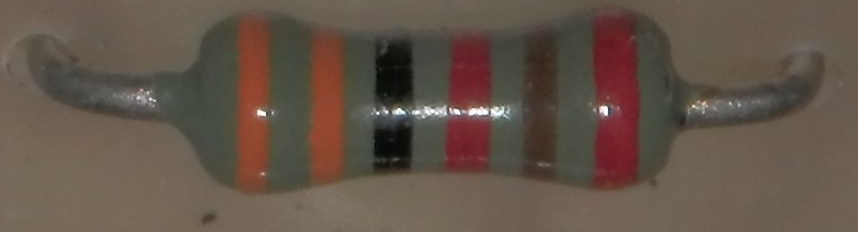

Anyone Know What This (Ed: Electronic part) Is Called?
Either way, whatever value it is - it's best to actually measure it with a multimeter to confirm it's value.
Well the whole point about it was the resistor was open circuit and I was attempting a repair.
for no3 - assuming that it is red,brown,red,black,orange,orange. = 212 Ω ±0.05% (W) 15ppm/K (P)
How about if it looked like this:

Random & Matty Those are the colours. Red Red Brown Gold

Thanks to Bernards link to the circuit above and Randoms image the only variations I see are 280KΩ Vs 270KΩ and 1K5Ω Vs 150Ω, both of which I'm happy to accept as reading the bands incorrectly or manufacturing differences.
I've highlighted the only position a higher power resistor would be fitted and it shows as 22KΩ or 24KΩ. That tallies with one of my laptops and 2 others diagnosis.
That is going to be running at approx. 2.5W 24/365 or 34KWh (£10) per year, trying to fit a 220Ω would be attempting to pass 1A and dissipate 220W. EDIT: just realised this is half wave rectified so the powers I quote should be approximately 0.5W and 50W. Doing that would not destroy the new resistor but instead will instantly destroy ZD1 immediately followed by IC1 and 47μF cap as a minimum.
