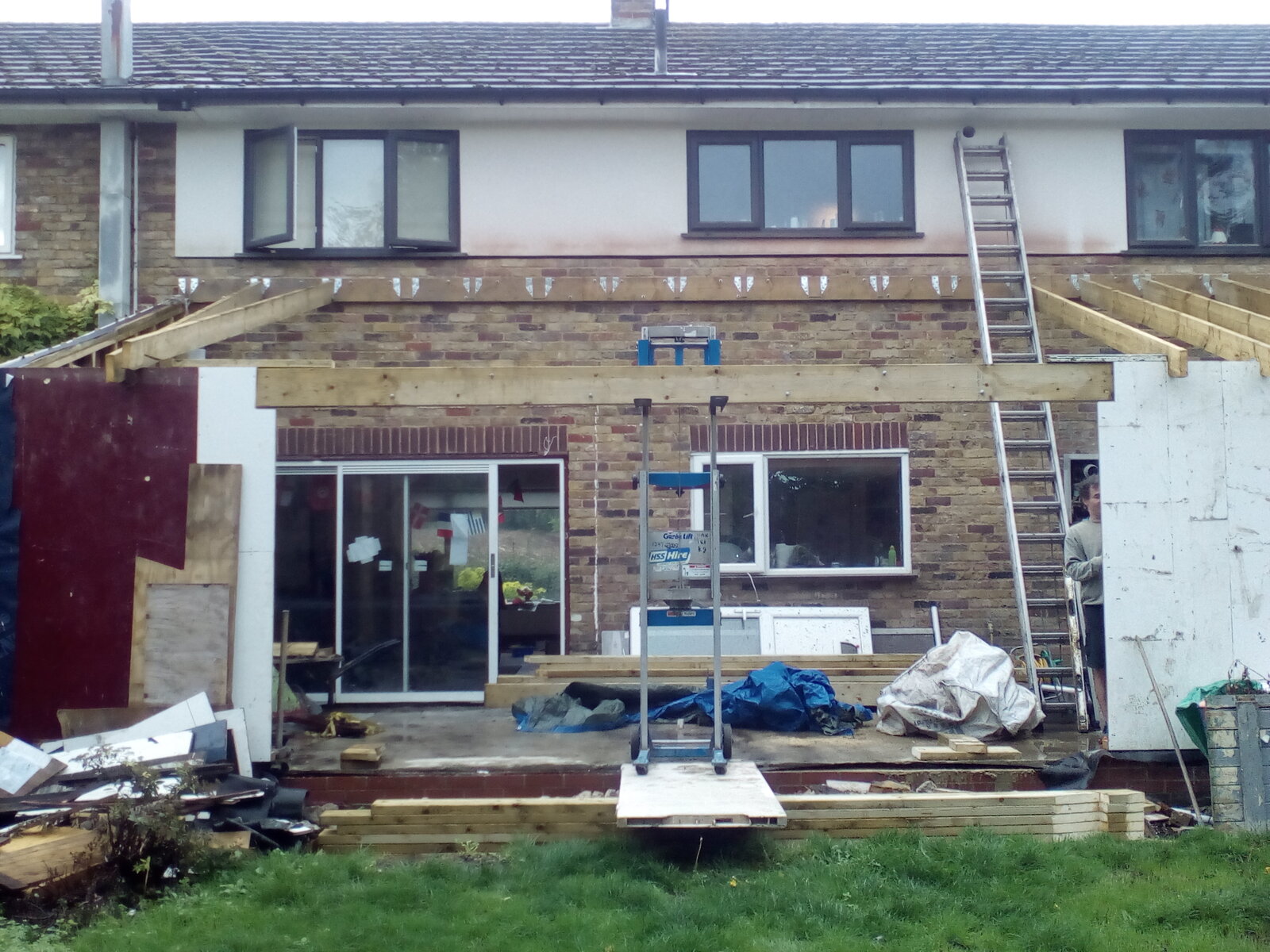

I need to install a beam thats got a plate welded to hold the outside skin of bricks so its a bit unevenly balanced.
Any ideas if it'll be easy to push the genie forward once it's at the right height and make slight adjustments to position the beam level and straight.
Also is it easy to pick up in a small van and assemble yourself or is it worth paying for delivery?
The beam is about 180 kgs. Ta
I presume you mean the type with two forks and a pair of handles (cable operated lifting mechanism), not the CO2 operated type.
If the floor is uneven just put down a sheet or maybe two of 18mm plywood to run the Genie on, or better still a couple of steel plates. They don't move well on soft or uneven floors. You may need to clamp your steelwork onto the forks (big G-clamp, Carver clamp, etc) , but make sure that you have the Genie at the centre of balance. It can take a few bodies, pry bars (and a few Anglo-Saxon incantations) to get big steels into position, but they will lift right up to ceiling level
Genie fork arms are held in place for use with removeable pins, removed for transport. The front feet fold into the body for transport, so you can take them through standard doorways on a site when folded up They will certainly fit in the back of a 1-tonne Transit/Dispatch size van and I imagine many big estate cars. One man can move one about the site (folded up) on his own on the flat - going upstairs or across soft ground will take 2 or 3 bodies

During the construction of my extension I designed a flitch beam. When the steel plate arrived (104kG) two of us carried it into the garden from the road.
I fitted the timber to each side and it was up at 150kG. After two of us managed to lift it up onto trestles at hip height I decided to get a Genie lift to get it into position!
Was it handy to wiggle it into position?
I don't think I moved the Genie once I had it in position - just moved the beam on the forks.
By the way, I don't think supporting the front of the Genie on an old door is necessarily recommended :LOL:
Also does anyone think a 215 x 450 x100 padstone is a bit big for that beam?
