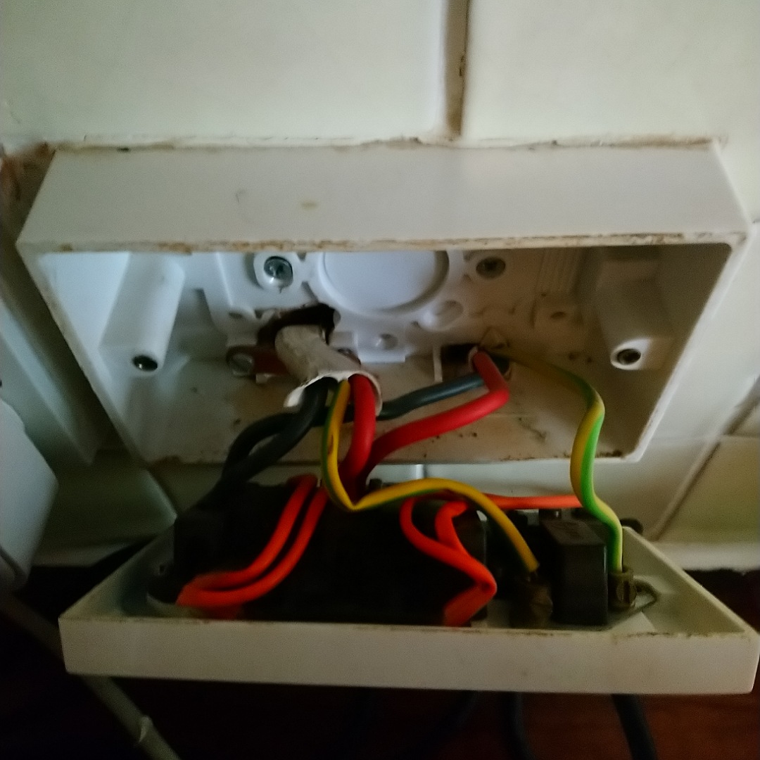

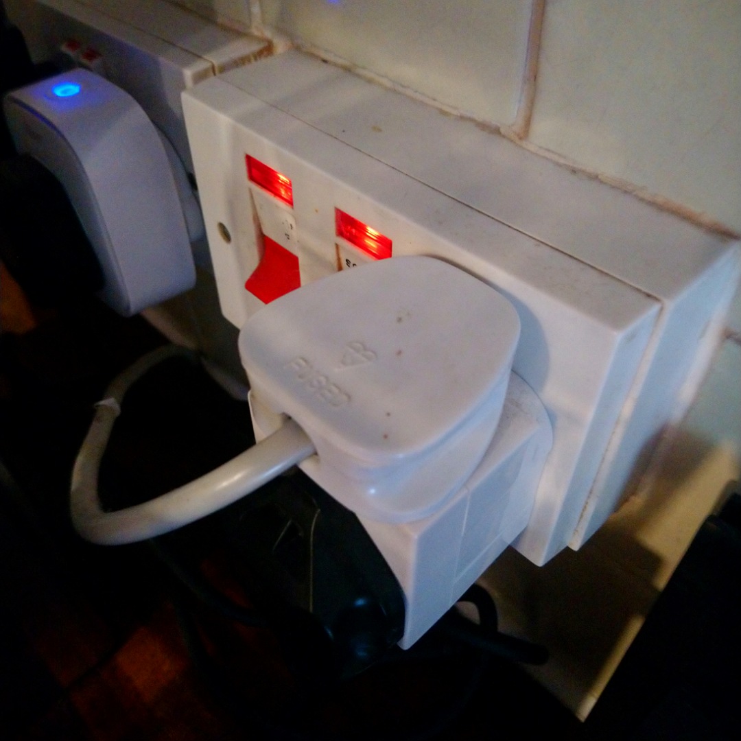

I presume by a "cooker socket" you mean the socket on a cooker control unit e.g.
ae235
It's not impossible that the socket itself is faulty or that some numpty wired it in a way that passes the earth through to the cooker but does not connect it to the cooker control unit.
but it's IMO far more likely that the earth wire has either fallen out or was never connected in the first place. In that case it would indeed affect both the cooker and the socket.
I'd start by looking behind the cooker control unit, then if I didn't find any faults there I would move on to looking in the consumer unit.
Ok can see the cooker and socket share the same earth. I cant see anything wrong on the socket so would suggest either the cable is fooked (big problem), maybe the socket but seems a long shot, or the RCD connection?

Sorry took a while to work out how to shrink photos, uploaded now!

That looks basically OK. When you feel the buzz and get a light on your screwdriver, what else are you touching?
It could be that the oven is actually properly earthed, but what ever else you may be in contact with is live or has some leakage.
Do you have a multi-meter?
