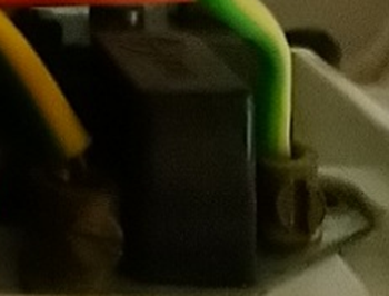

Earth into the socket is 240v, live is 240v.. I'm a bit mystified how either the fault could suddenly appear or it could have been wired like that for the last 20 years?

The earth wires in the socket go to different terminals. Do those terminal connect together internally?
Joined by a metal plate I would think, can't be sure if the earth sleeving is trapped under the screw on one terminal mind.
One can't be certain, but it looks as if the two terminals are both rivited, welded or brazed to the same brass plate ...
Cheers all. Its not the socket, I swapped it and the faceplate (metal) was live. Turned out was the earth conductor. Could be the sleeve or damaged live or fault in the CU or elsewhere in the cable.... Will check a few more things later this afternoon but all off for now. Microwave dinners it is!

It's not impossible that the socket itself is faulty or that some numpty wired it in a way that passes the earth through to the cooker but does not connect it to the cooker control unit.
but it's IMO far more likely that the earth wire has either fallen out or was never connected in the first place. In that case it would indeed affect both the cooker and the socket.
I'd start by looking behind the cooker control unit, then if I didn't find any faults there I would move on to looking in the consumer unit.
