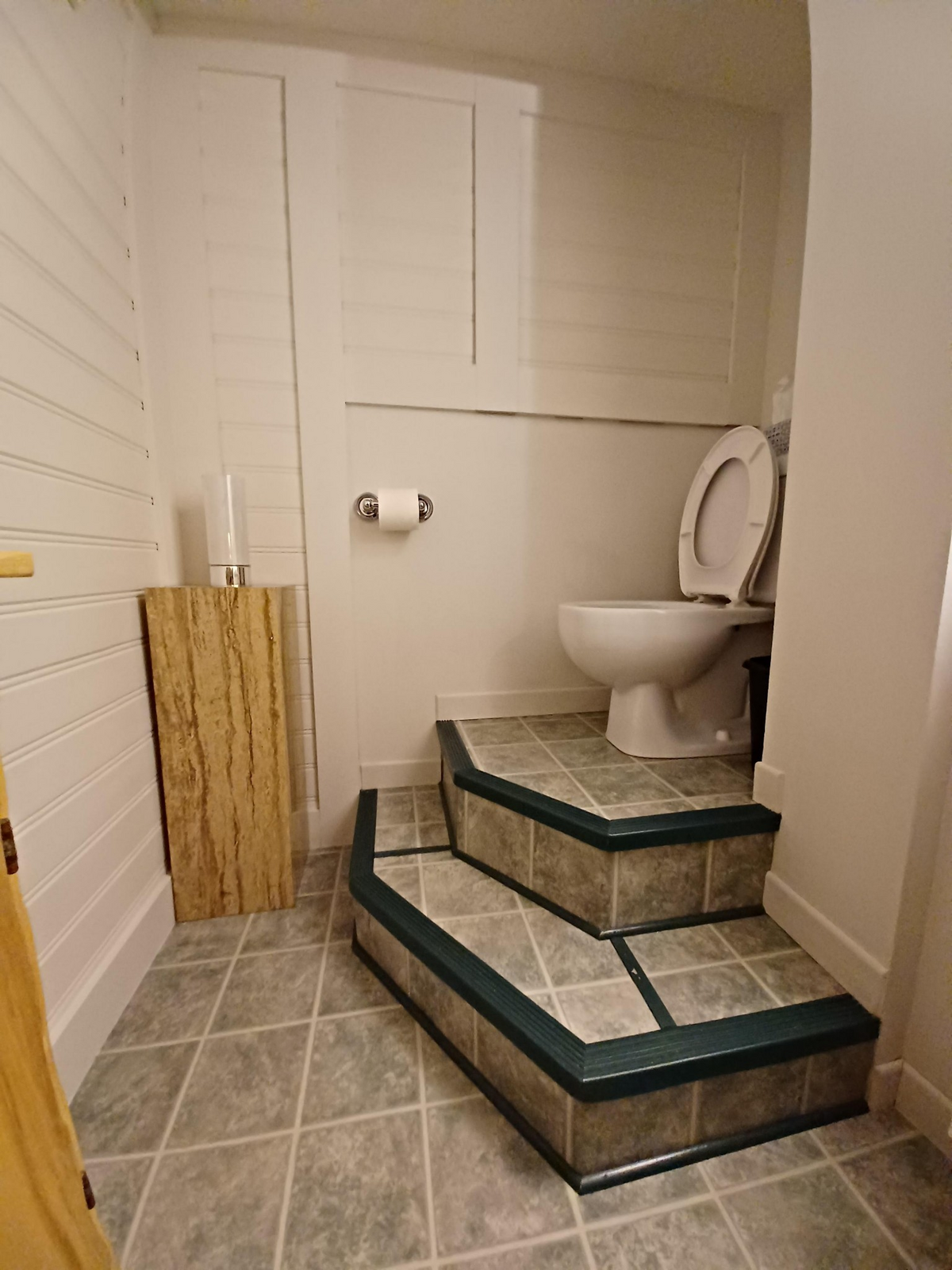

It isn't going to work is it. If the manhole is only 14" deep and it really is 33metres, you need ~40cm fall for 1:80 - it'll be out the ground by the end.
Perhaps? :)
