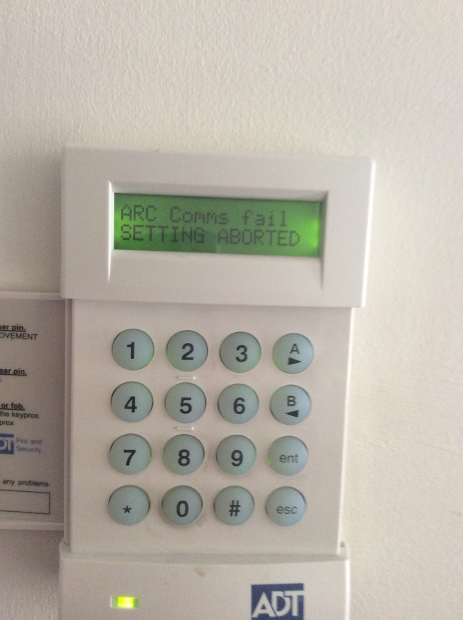

I have an ADT alarm that is no longer monitored and has now come up with the fault "ARC Comms fail - setting aborted" when I try to set it.
I have been able to bypass and set by going through fault override but cannot clear the fault as it continually says user reset required and all I have is my user ID.

You need someone in to default the control panel enginner code then programme the comms part off the system. Until then your have problems as system is looking for phoneline & the monitoring station until the system is programmed to not look for it.

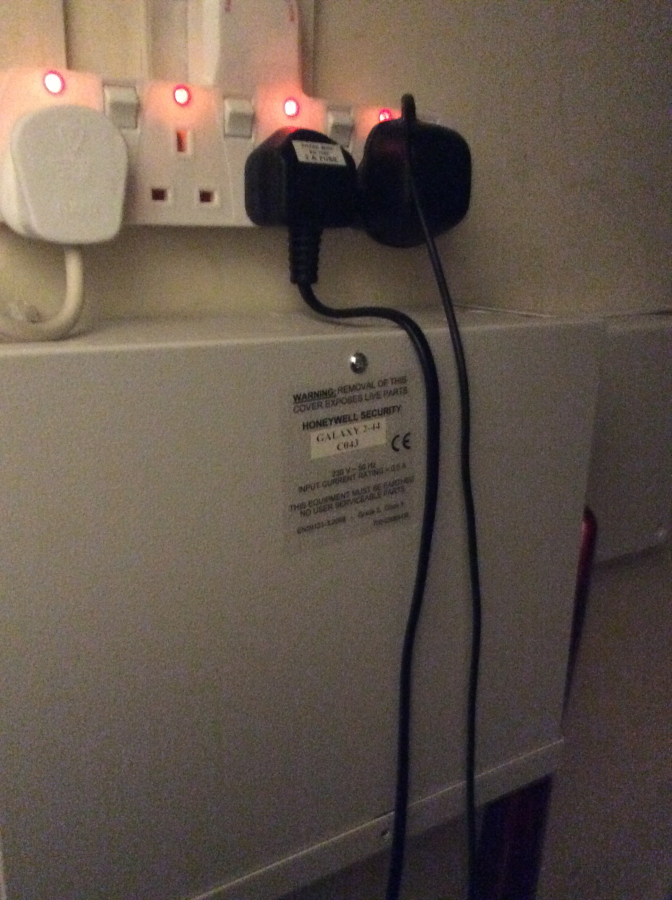

Someone else on here may be able to help. Depends what control panel you have. I'm guessing you have a Honeywell Galaxy (Portrait keypad with seperate metal cased control panel???)
Yeah its a Honeywell Galaxy. Like I say the comms feature needs programming off the system, its protected by an engineer code which ADT will never give out. However these systems can have the engineer code wiped & reset you just need to find someone who knows these panels. Most firms will want to flog you a new system so your need to find an independent enginner. If your in the South east drop me a private message & i may be able to help.
