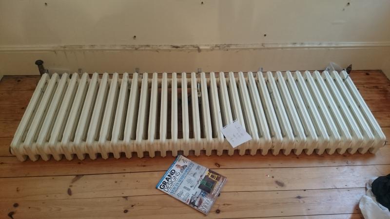

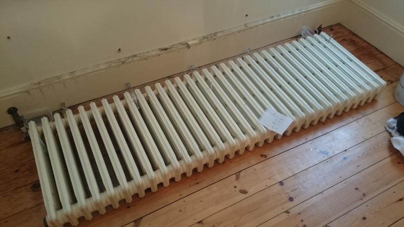

After taking the sound advice on this forum I decided to remove my radiators and clean them in the garden to get rid of the thick sludge that is blocking them up.

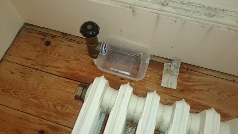

I started with the radiator in the lounge. Closed the valve and the lockshield, undid the nuts and slowly drained the radiator. So far so good...
However, i totally underestimated how heavy these things are! As soon as I undid the wall fittings it fell on the floor and now I can't shift it.
Luckily it all looks undamaged, but it is too heavy to move. I have given up on trying to flush it, but I can't even get it back on the wall.
Can anyone help. Is there a good way to do this?
The picture is below (magazine is to show scale)
Help please! Thanks.
