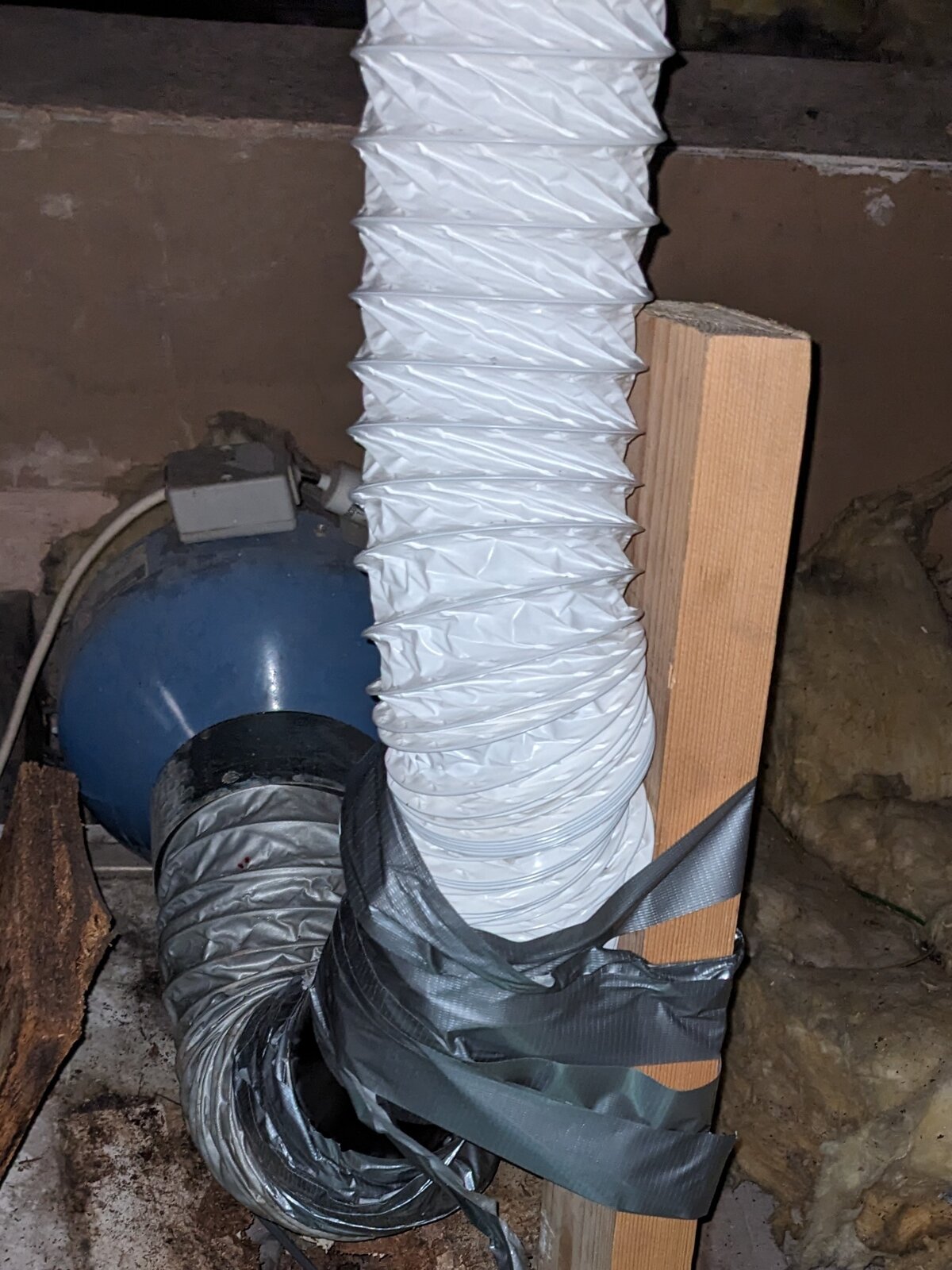

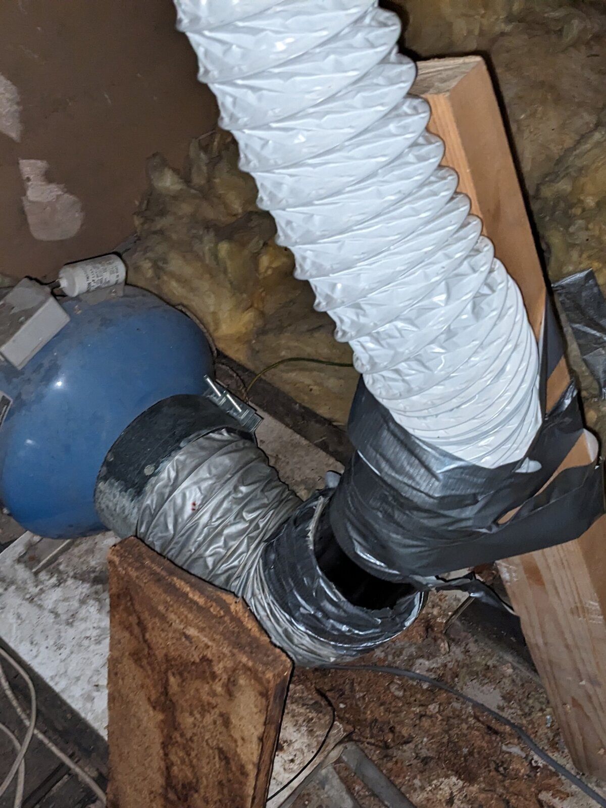

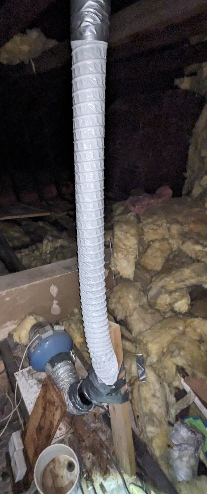

Attached some pictures of the work I'm not happy about (ignore the insulation, it's in the process of being replaced). Is it acceptable and I'm just being too strict with my interpretation of the regs?
There is another way of looking at this. In all contracts there is an implied obligation for the deliverer of the product or service to do so with reasonable skill and care. A measure of what is RSC is compliance with any guidelines, which although not mandatory do indicate the agreed standard that a professional deliverer of that product or service should adhere to. If they deviate, it doesn't necessarily mean the alternative is wrong, but it does it make it a bit harder to show it's right.
If the install was tricky, then I understand if some guidelines were stretched. But the system is in clear space, easy access, and the replacement pipe was a suitable length to minimise the flex until they cut it. I know they cut it cause they left the rubbish behind.
I don't see any valid reason for doing it the way they did and other than laziness/incompetence, incorrect materials to hand, and wanting to get it done as quickly/cheaply as possible.
It just annoys me that they cut the PVC pipe too short (the end of it is at the top of the first picture) then tried to BS it as intentional due to weight. If the weight of 2ft of pvc pipe matters, the fixings used are insufficient.

What a load of bodge!. The fact that it is tripping out the electrics proves this. IMHO there is no way that is going to work - it's just going to be a condenser - warm damp air going up in to a cold pipe - the condense is going to run straight down in to the fan, which is possibly why it's tripping.
It's not going to make much difference if the pipe is flex or solid as far as creating condensation, but you need solid pipe to fit a condensation trap https://www.extractorfanworld.co.uk/blogs/condensation-traps
Tell him it isn't fit for purpose and to do it again properly and don't pay him for this element of work until he does. I do hope the rest of the work has been done with a little more care to detail!
That's what I'm thinking but I'm not sure yet. The system has 2 fans on it, the blue one pictured and a vent axia on the kitchen ceiling installed by the previous owner. It's an internal kitchen with no windows, I think building control required them to increase airflow and sticking a fan inline was probably the cheapest way but I'm not sure.
The blue fan has stopped working since after the install. Again, don't know if it's coincidence or condensation, but either could result in the electrics tripping. I'm going into the loft this weekend to put away the christmas decorations, so I'll un-tape one of the sagging flex's and see how much condensation has actually accumulated.
