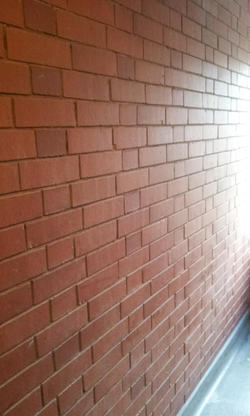

As it happens I was just passing this
Engineers can look quite nice as face work, but they are unforgiving of poor bricklaying.
There are also types which are nice and square and smooth, and others which are bent and cracked
