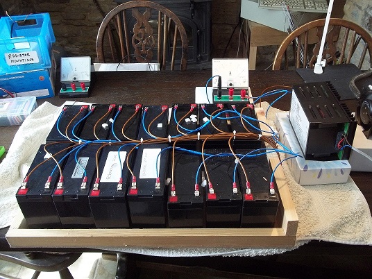

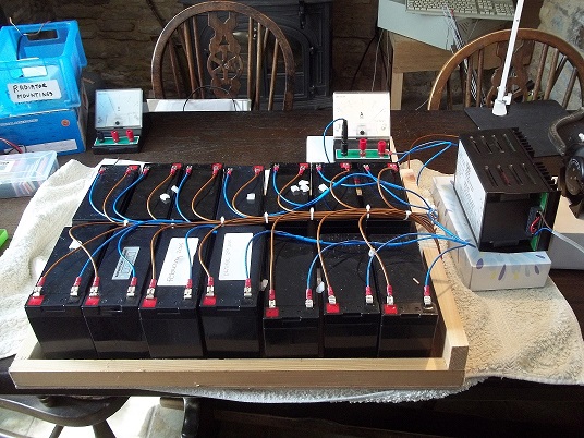

I used 10 Ah and 7.5 Ah batteries from both Rapid Electronics and RS Components for the lighting at my daughter's wedding, most were bought new for the event but some were from February 2013 or before. These "old" batteries ( from Rapid. Brand Haze ) had not been cared for, some had been cycled a few times and some just left on the shelf but they all had capacity very close to the rated capacity after a re-charge .
