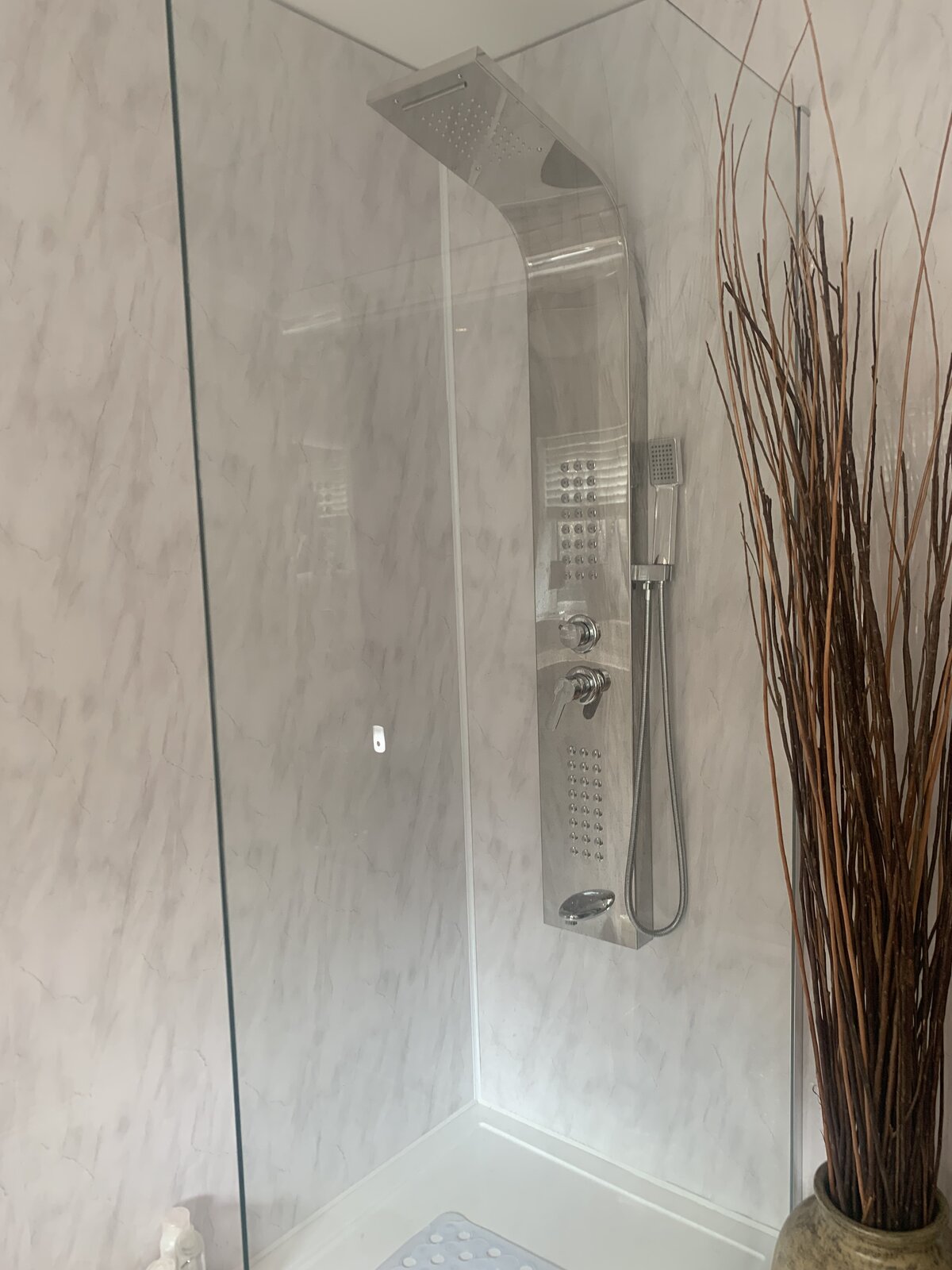

Hi, I'm getting my bathroom redone, these large plastic tongue and groove plastic wall panels, I know they are supposed to have a strip of silicone before fiting together, however do these panels leak?
Perhaps after a couple of years etc.
I have a bathroom fitter that thinks they do.
Also what do they do in a corner?
No they are fine installed correctly , corner and edge profile are used ,if you have a shower tray a purpose made base trim is fitted to avoid leaks .
White corner trim in pic , other colours available .
