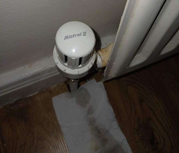

They don't work terribly well - turning them up or down doesn't make as much difference as you'd expect, if at all.
More worryingly, recently two of them have started leaking.
So... (deep intake of breath at the thought of the expense) if I'm going to have to get a plumber to replace two of them, would it be better to bite the bullet and get him to replace the lot?
This is the type they fitted - are they crap, or have I just been unlucky?

Where exactly is the leak coming from ? Is it where the pipe enters the bottom of the valve ,or somewhere else entirely ?
I don't know how good ,or poor, that brand of TRV is ,but if you mostly have them fully open and you are not kept warm ,it's more likely a boiler issue ,not the TRV.
I haven't looked at the one in the hall yet, but a guy from a local firm who services boilers was round a month or so ago, and he pulled the top off the one in the bathroom - pretty sure he said it was leaking from the actual valve (internally). He only does boilers, so wasn't willing to look at it as a job unfortunately.
Well... the bathroom one is definitely leaking from inside the valve, but I'm now pretty sure the hall one is leaking form the joint between the TRV and the rad :unsure: bit of a coincidence for them to fail in different ways at the same time, but there we are... doesn't make a lot of difference to me, as I can't fix either :confused:

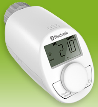

I have replaced the heads, not whole TRV, just heads, I have used three types, are reasonably cheap, but since Brexit the price has gone up a bit, so £15 each for eQ-3 61dmtMm13BL.jpg bluetooth, but can be manually adjusted, uses ºC not silly *123456 as do all three I have used, is programmable, will only work with one phone so either myself or wife has control not both of us, it has window open detect so can shut down automatic for set time while back door is open and emptying car of shopping, like the others powered with 2 x AA batteries, only shows target temperature, single button will toggle between comfort and eco setting.

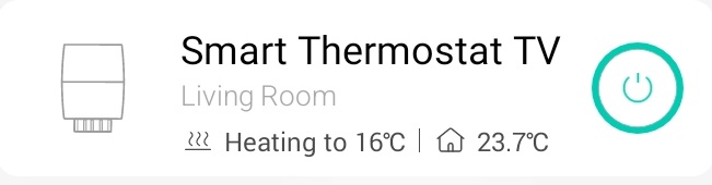

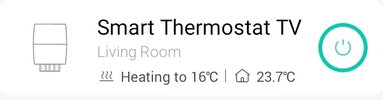

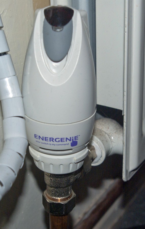

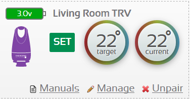

The Energenie IMGP8035.jpg works with PC or Phone, does not allow manual adjustment, needs a hub, has two sensors one for air temp and one for water so compensates for heat from radiator think cost was around £75 a pair, the display shows both current and target TRV_report.jpg so very easy to set lock shield valves, the battery cover is easy damaged and the collar holding the screw tread to hold into the TRV is easy broken and one needs to use a spacing piece to match to some bases, the geofencing using IFTTT and like others is programmable, but the anti-hysteresis software is OTT so would set to 22ºC at 7 am then 20ºC at 8 am to get around the software.

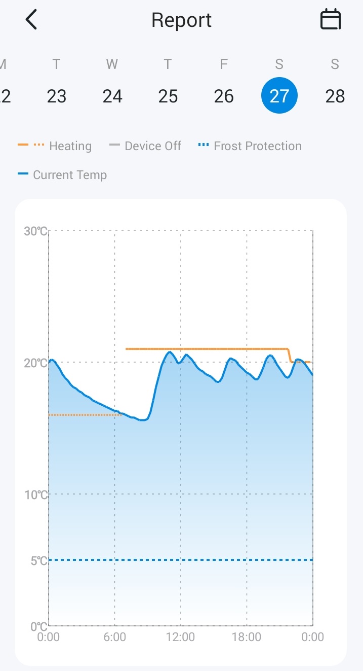

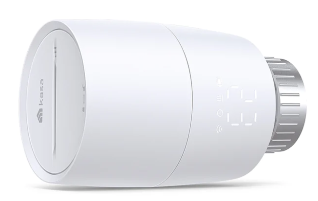

The Kasa (TP-Link) 1711312890277.pngbest of the three used but most expensive at £35 it needs a hub, and like the eQ-3 auto sets its self up for how far it needs to move, also like the eQ-e has a kit of parts to fit a selection of TRV bases, can be manually set, and the software has a report Report full day.jpg to show how heating is working and does show target and current TRV Kasa.jpg to help set up lock shield valves, it needs a hub, with like the Energenie can also work other things, most non mains smart devices need a hub as to connect direct to a router uses too much power, however this one simply plugs into mains, the Energenie one needs to be hard wired to router.

With a TRV head which shows current and target one can reduce to lock shield valve setting until the current never exceeds target, and the Energenie in my mothers house once set were spot on, this house the boiler is not a modulating type it is oil, so there is a sine wave where the boiler is turning on/off as well as the TRV head.
When we sold my mothers house, having already set the lock shield valves, when refitting the mechanical TRV heads they also worked A1, but to set using *123456 is near impossible as you are trying to work out both the TRV and lock shield setting at the same time.
