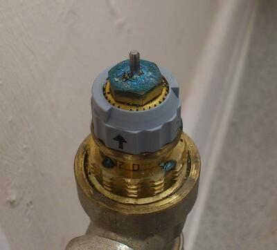

I've had a sticky goo out of one of mine, fitted by a former owner. It's black and went all over the floor, skirting, valve and pipe.
Are you saying the sticky goo is coming from the head itself, rather than sludge coming through the pin or gland? As these are liquid thermostats, could it be the liquid seeping out?? I presume they no longer work properly once they've dropped their sticky goo? (!!!)
The goo is yellowish in colour. As best I can tell, it comes from the head itself. It oozes down the outside of the metal bit of the valve before dripping onto the floor. But then it sets harder / stickier, presumably as it cools.
It's difficult to tell how much the head's performance is affected by this leakage - it seems fair to assume that it no longer works correctly...

Well, this discussion has prompted me to pay a bit more attention to the problem...
Last evening I replaced two more of the heads, and realised that they were two that I'd already replaced previously. Examination revealed that, in fact, it's the valves that are leaking around the pin. Probably not the heads at all :(
I now believe that the sticky goo is "dried" system water (which is well dosed-up with Fernox F1).
However, I did compare the weights of my collection of TRV4 heads (I didn't throw all the old ones away...). Three were 141 grams, but one was only 125g. So perhaps that one did leak wax, and I falsely assumed the others had failed in the same way?
Can the leaking valve pins be cured? Or is it complete new valve time?
The heads on TRV4s are alcohol mix filled. That should be a clear liquid!
Cheap TRVs use a hard wax which would not normally come out. They take much longer to respond than liquid filled ones.
CH water should not be a dark green sticky colour.
Dark green and sticky is usually the result of adding a sludge cleaner which has not been properly flushed out!
More common than you might expect!
Properly cleaned system water is in the range from clear to slight straw colour!
