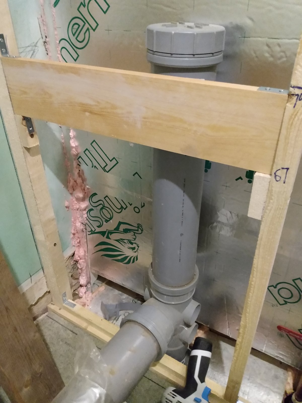

Are the screw holes for most toilets 67 to 79cm high?
JP_
17 May 2012
10,782
849
Because that's where i put this bit of wood
Do you have the toilet to check?
Why not just put a larger piece of wood in there to cover all bases. Some 18mm ply would suffice covering a larger area
No toilet yet. Looked at dimensions online and most are max 80cm tall, so assuming the fixing holes are a bit less, not too much less.
Could find another bit of wood, this was a leftover bit of 20mm floorboard, might have some more ...
