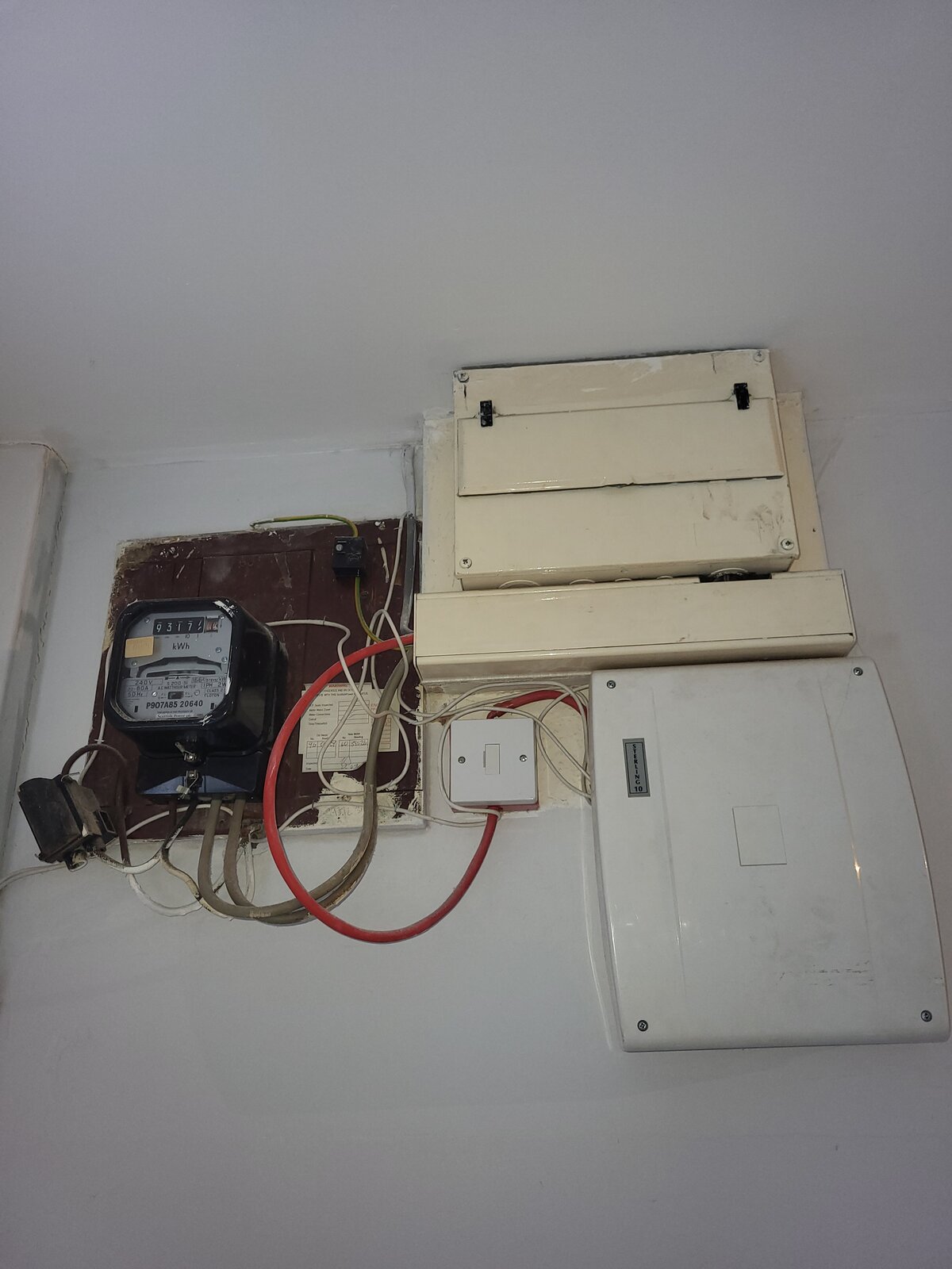

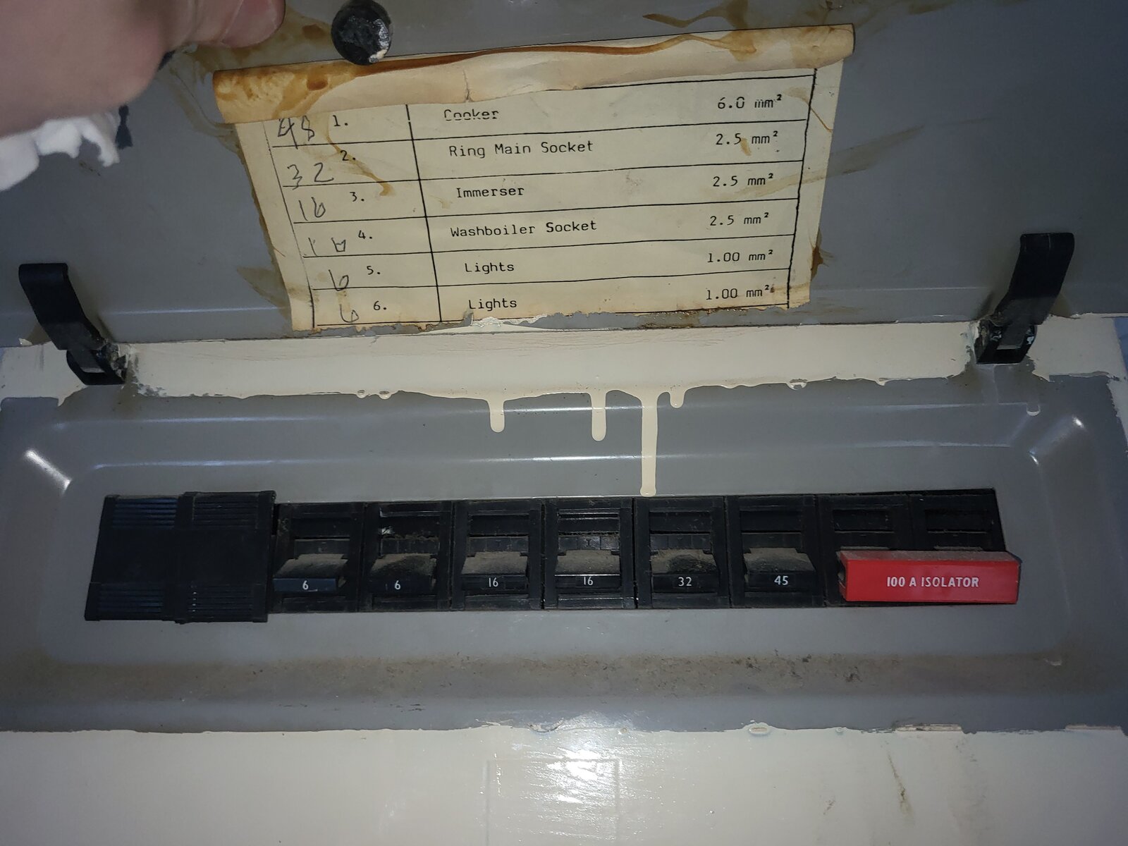

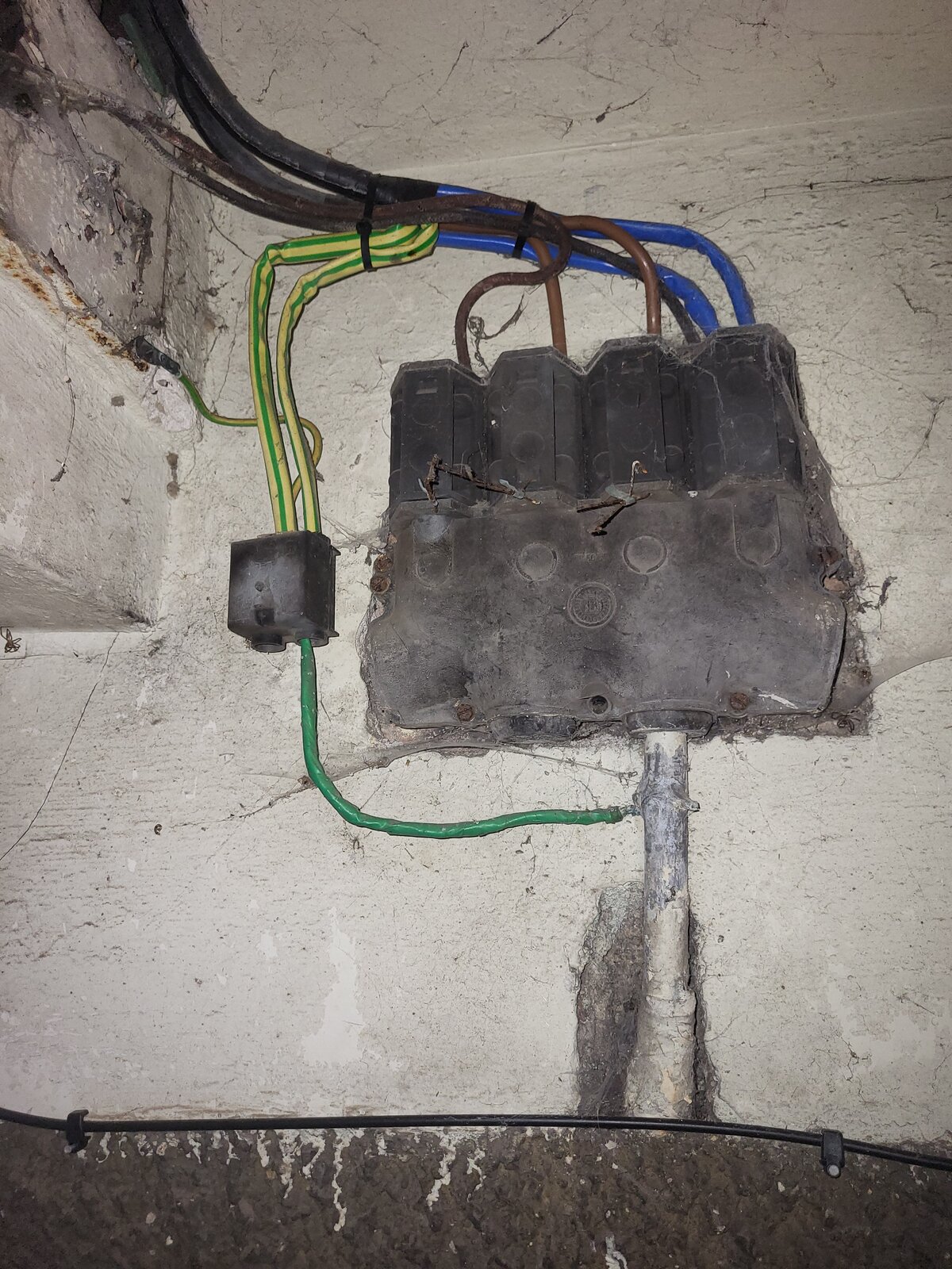

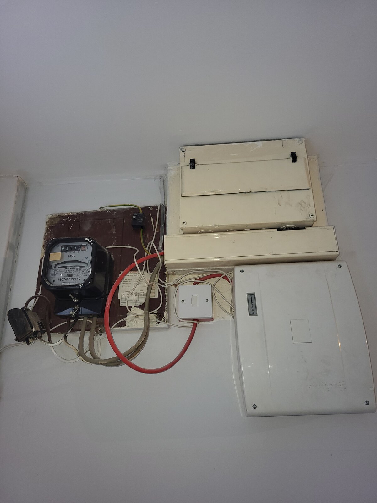

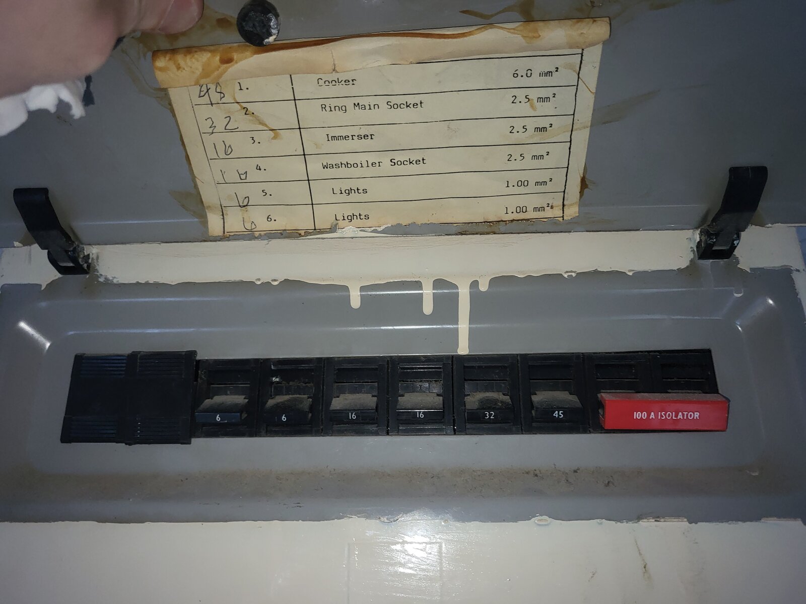

Yes its a serious question? A whole house rewire? Can you tell from these pictures if I need a more modern CU and theres no main earth and I have an old VIR cable and no RCD protection?

Sadly those photos don’t tell me much tbh. If you have concerns about the installation my advice to you is get a proper and decent EICR done
If you have VIR cable I would recommend you don’t change the fuseboard only

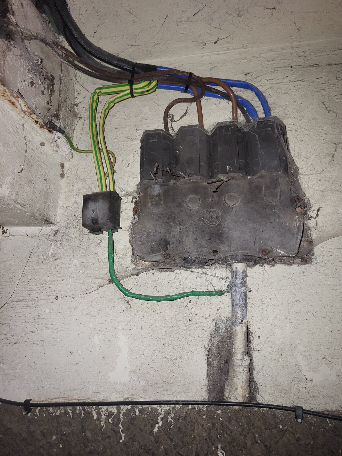

The incoming supply looks a mess. The incoming tails look old, the fuseholder is skew-whiff and it does appear that there is no earth connection from the supply.
But, if the supply is TT, you will have to provide that yourself via an earth electrode.
I would contact your DNO and ask them to check their supply is safe.

Re the VIR issue. It’s not clear if the VIR comment referred to just the meter tails, or to other wiring in the house. If there’s VIR cables within the house itself then a rewire is decades overdue. If just the meter tails then not such a biggie.
But for an installation of the age that yours appears to be you must must get an EICR done. If you don’t then, after you’ve redecorated etc, you may be faced with ripping the place apart when events make you gave the place rewired.
Sorry, can’t sugar coat this.

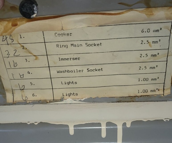

A big assumption, but if the metric cable sizes noted on the CU can be believed, it may only be the tails.
For the sake of the OP, don't panic.
There is a lot of information in this thread - yes, your wiring isn't up to current regs and doesn't have the protection of RCD's etc. but that doesn't immediately make it 'unsafe' - from the limited information we can see, there are many households that have wiring in similar, or worse states than yours - mine certainly was!.
As has already been mentioned, an EICR should give you a fuller picture of the state of your wiring - priorities for improvement can be made after that and may not be as bad as you imagine.
Judging from the photos the OP provided....
The tails from meter to his consumer unit, appear to be grey pvc. Those from his cut-out to the ancient meter, appear to be VRI. It's difficult to comment more, because I cannot see much detail around the cut-out area, or incoming cable head.
If the above is correct, then it will be the DNO's job to replace the VRI and the meter, with a new one. I would ask that an isolator be installed at the same time, making it much easier to replace the consumer unit at a later date.

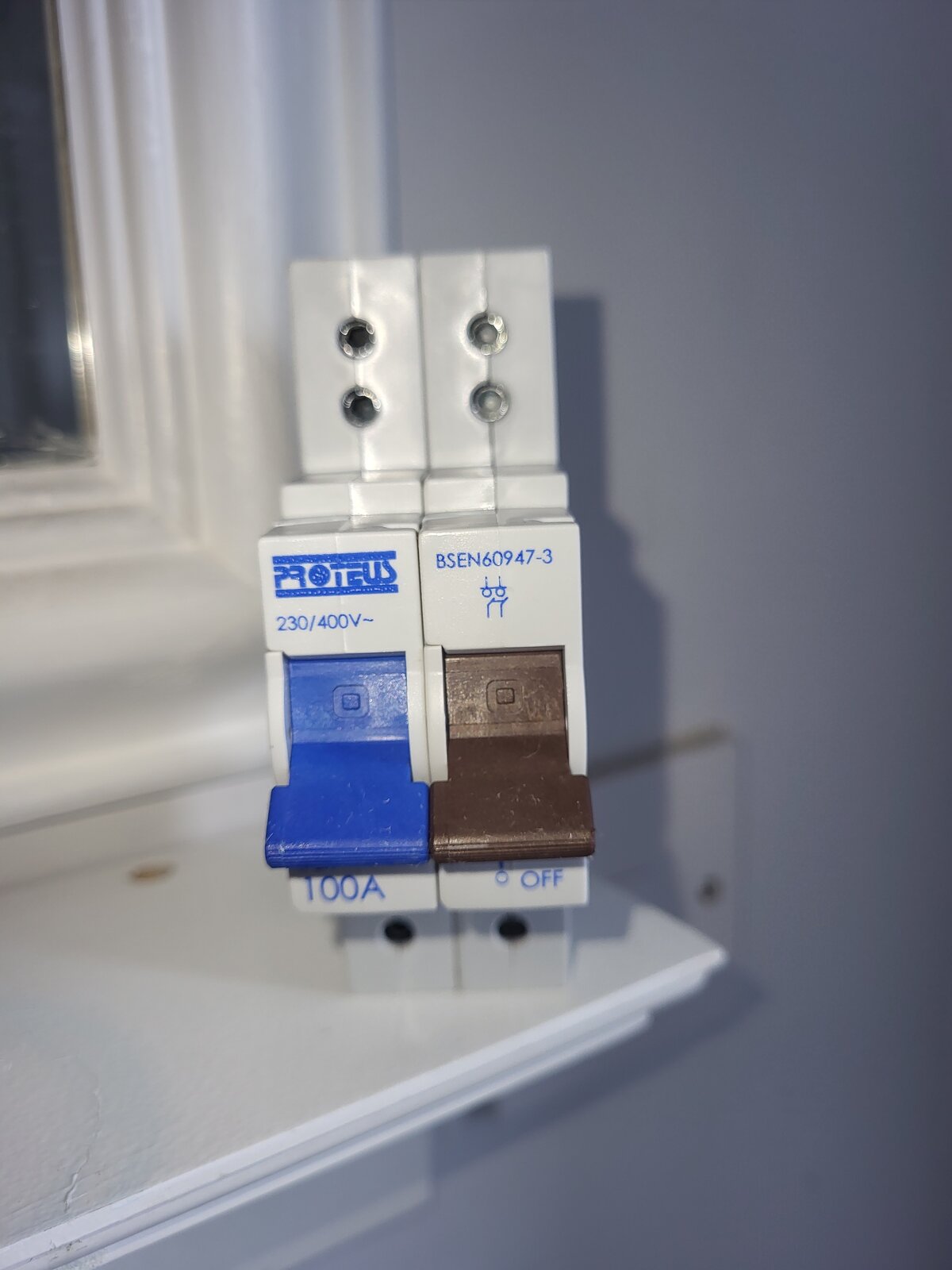

Update

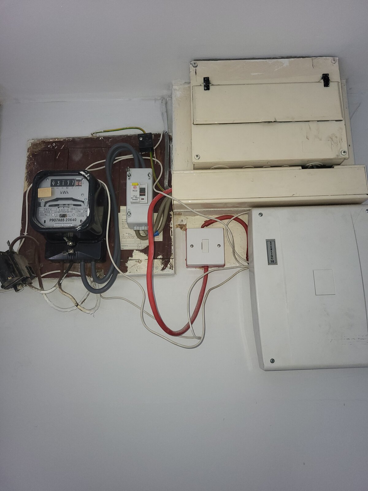

I had the local energy supplier DNO out today and he added a RCD. He said he has notified another company who will now replace the VIR cables that go into the metre. He said they will also fit this other part that I have attached the picture of, anyone know the name of it.
He said its now safe but recommended new CU.
He said it is earthed he found it at the back, the single green and yellow cable the house picture with the metre ( also in the photo of the outside in sheltered alley way that the earth is connected too ) but it's the small green and yellow cable behind the two larger green and yellow cables (out door picture), the two larger cables are the neighbours. He said it was connected to the earthed outside in the sheltered pathway. I'm not using his exact terminology words as can't remember but basically this is what he found.
He said if we were getting a smart metre then best wait until the VIR cables are upgraded.
He said he can't judge on the wiring in the house if they need upgrading or not.
He said he sees 100s of properties like this and doesnt make them unsafe.
However he said its safe now he has added the RCD but recommended a new CU.
Up to us of we want to get an EICR report, not his area.

Update
Lucky you, I wasn't aware of them fitting RCD's for free.

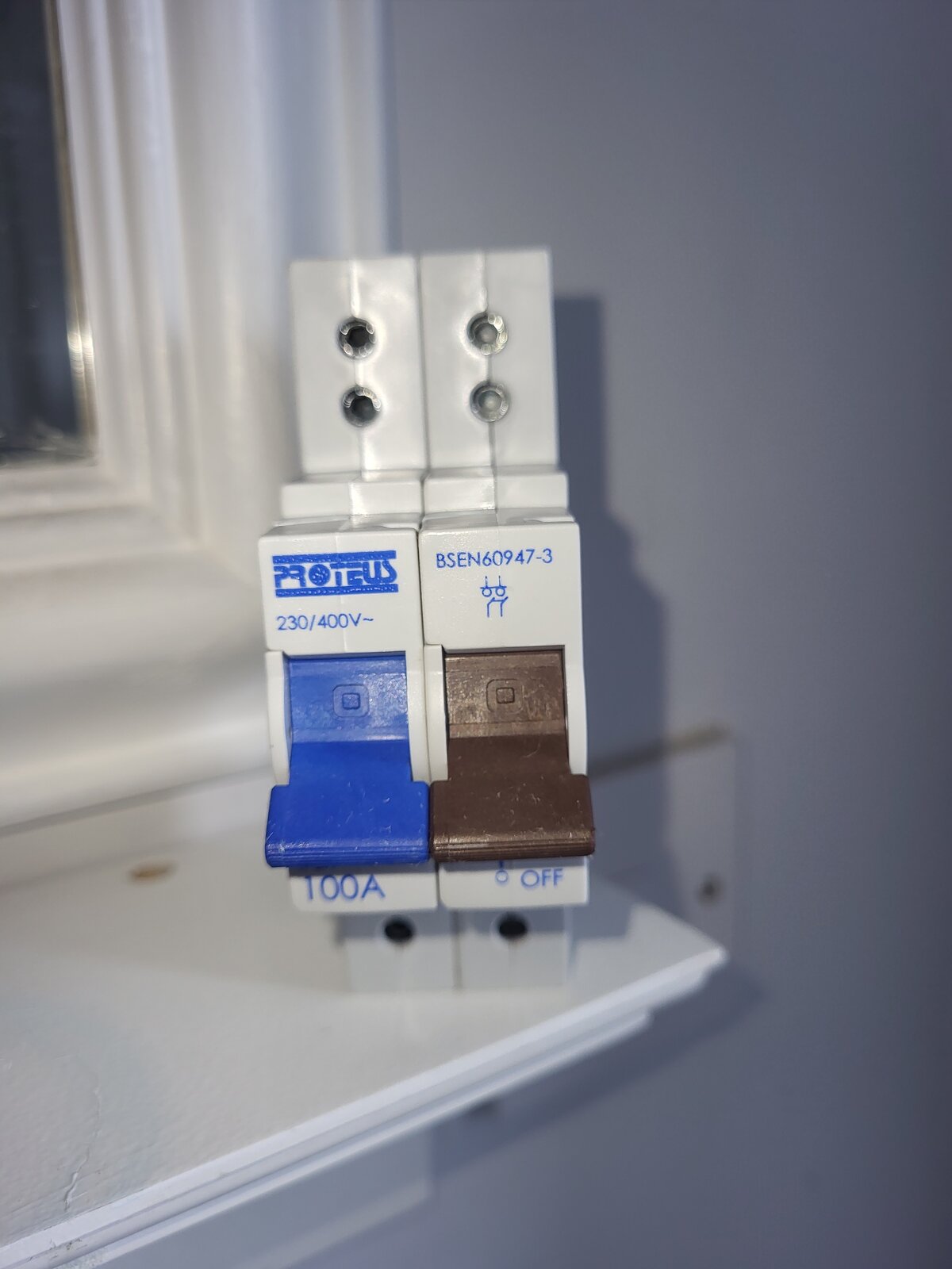

That item is just a double pole isolator, unnecessary
I would have expected the VRI to be changed at the same time as the smart meter was installed, However, when the VRI is changed - that would be a good opportunity for the earth wire to also be upgraded to modern standards.
to fit that now, as well as the RCD. They both serve the isolation function.
Thanks, if you were me what would you do now?
