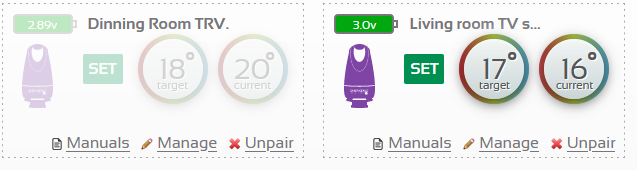

But does this new analogue control really work? I look at my TRV heads and so often I see this
as you can see dinning room greyed out, as to if still working not a clue, if it was sending info to control central heating rather than simply just telling me what is going on, would I have a cold dinning room when heating failed to run, of hot house when it failed to stop.
