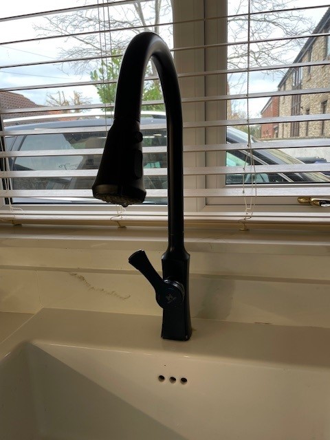

I moved in to my house 2 years ago and changed the taps in the kitchen to a mixer tap. Since then I can't get hot water out of the mixer tap. I believe it is due to the mixer tap not allowing as much flow as the original tap. However this has now started happening in the bathrooms. What I have discovered is that if I run two hot water taps at the same time I can get hot water, but just one at a time doesn't seem enough flow to get hot water.
I therefore believe my Ariston Genus 27 BFFI Plus Boiler is requiring more flow than usual to trigger the hot water, as time goes on this seems to be getting worse. Any recommendations on what the issue could be and what part of the boiler might be causing this issue?

Please post a photo of this tap
And the pipework under the sink that connects to it.
Fill a bucket. Time it. Calculate litres per minute.
Run a cold tap elsewhere when asking for hot water. See if that makes a difference.

From the tap set to hot I get 4.6 Litres per minute
From the tap set to cold I get 5.5 Litres per minute
Running a cold tap elsewhere didn't make any difference.
At first I thought the new tap was at fault but as mentioned this is now happening elsewhere in the house, for example I can only get hot water from the shower if I run the nearby sink hot tap at the same time.
